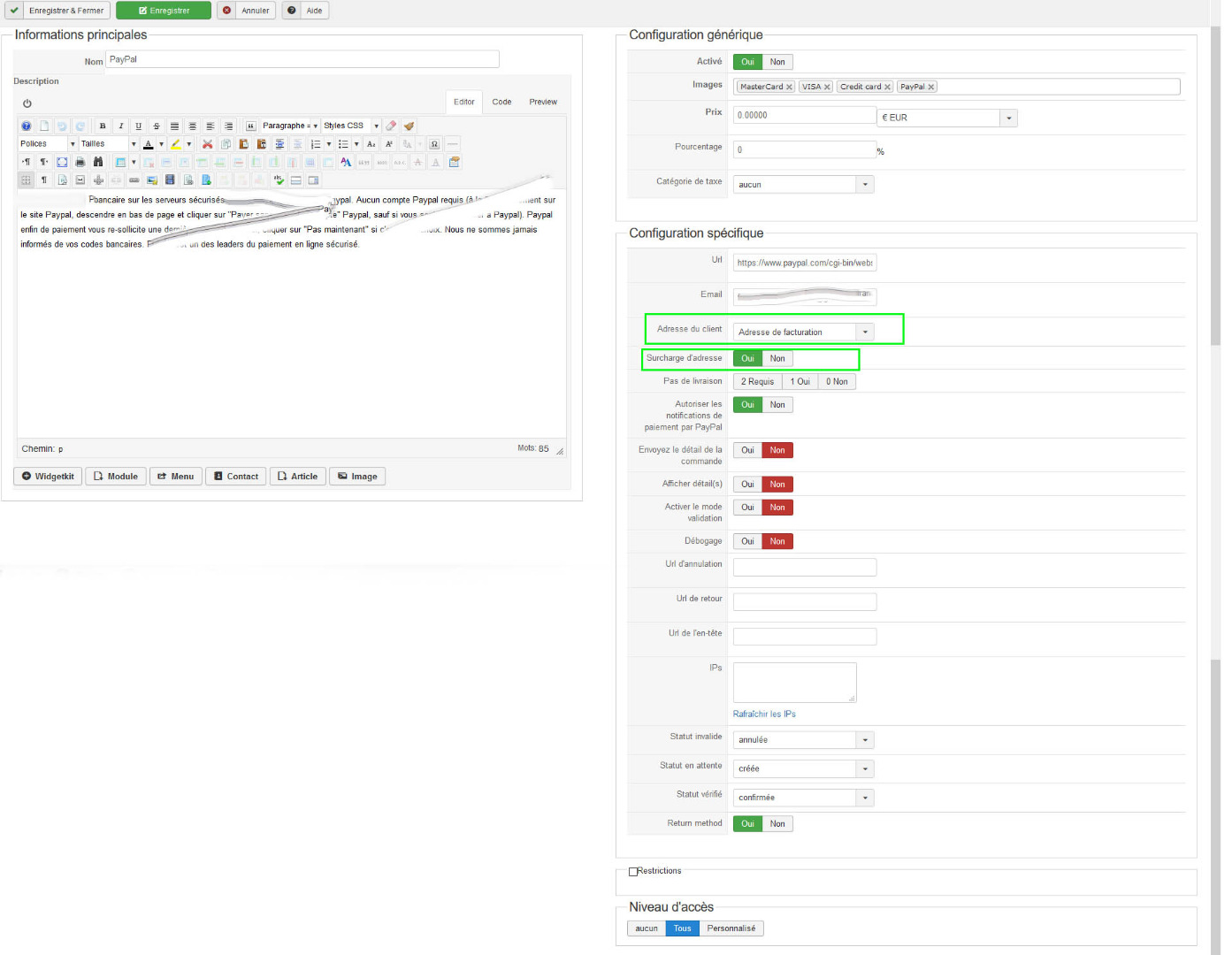

1 /About - you can turn off the sending of the address to PayPal in the settings of the PayPal payment method. :
How can I do that ? Is it the "Adress override Yes/no selector (surcharge d'adress in French) or the "customer adress" choice = noadress (adresse du client u=in French)?

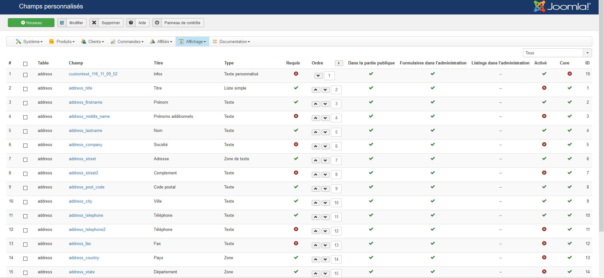

2/ About - you can configure your custom fields so that the data sent to PayPal for the address cannot be wrong.
I don't really understand what and how to do this ?

In you case, setting the "Customer address" to "No address" will probably do the job.
As it's said on the PayPal documentation :
Customer address : If you want, you have the possibility to include the billing or shipping address of your customers to the paypal payment engine. That will avoid them the hassle of reentering it on paypal if they don't already have a paypal account. That option is turned on by default.
Address override : If activated, the address specified during the checkout overrides the PayPal member’s stored address. Buyers see the addresses that is passed to PayPal, but they cannot edit them. PayPal does not show addresses if they are invalid or omitted.

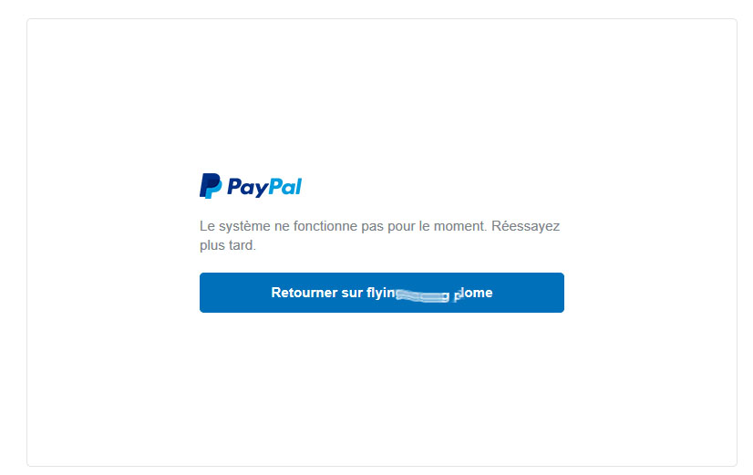

Yes I had read the documentation. Setting the "Customer address" to "No address" don't change anything Paypal Payment works fine on my onlinewebsite on production [.fr > J3.8.0 HS 2.6.4 PHP 5.6.31 ] but not with the one on preproduction [ tempo on .net > J3.8 HS 3.2 PHP7.0.22] ! I have now this Paypal message at the end of the process payment on paypal website: "Le système ne fonctionne pas pour le moment. Réessayez plus tard." The parameters on the paypal plugin are both the same...

You should turn off the "address override" setting.
That's what is forcing PayPal to use the address you provide, but if the address is deemed invalid by PayPal it won't let you continue.
And regarding your custom fields, you should activate the country field and instead deactivate the countries you don't want to support in the menu System>Zones.

I turned the override adress to no and had activated the contry selector in the customs fields. The France and France metropolitan are also activated in the zone aera.
At the end of the paypal process I have this message problem
I don't understand from where is the pb ...
