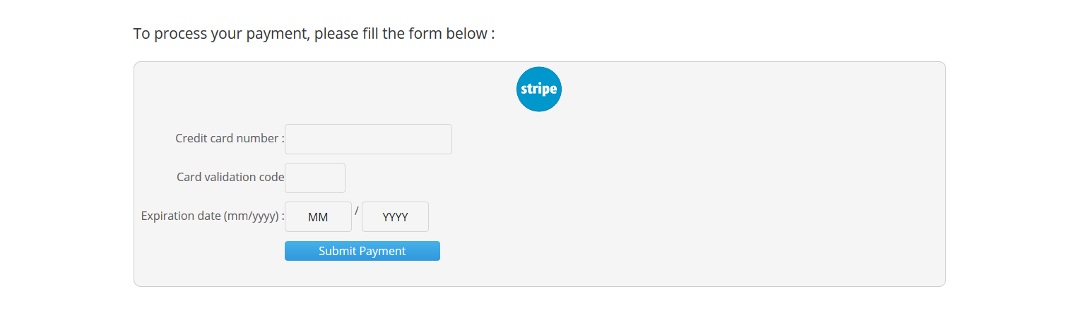

sorry for my ignorance, but I need some help. I am working to set up my first store, and have chosen Stripe as payment method. However I find the appearance of Stripe to look.. well, not good. It looks a little outdated, and not like a payment window where a customer would trust their credit card information.

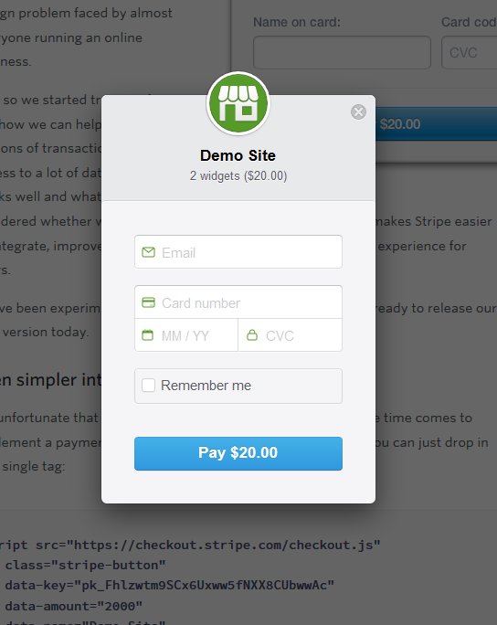

I have read the documentation and realize that the plugin has been moved from Hikashop to Github. I have updated the plugin, but it doesn't look good (see attachment). I found this blog on Stripe (from 2013) where the payment window looks great: https://stripe.com/blog/stripe-checkout
Now, my question is - any chance to find a Stripe plugin for Hikashop looking like the one in the blog? Does anyone have it, or does the Hikashop team plan to enhance the current plugin? Is there something I can do myself in the settings?
If not I assume it would require custom development and editing of the current one (which is beyond my capacity). The blog describes it like plug & play: "We decided to build something that you can just drop in as a single tag." But I guess not, since the current plugin and the one in the blog looks so different.

Stripe as it appears on my install:
Stripe on the 2013 blog:

The HikaShop stripe plugin is using the Stripe V2 API.
The blog screenshot looks like to be related to Stripe Checkout (which is very different than Stripe JS).
Afterwards, we are currently working on a Stripe V3 plugin which will be compatible with Stripe Connect and via "Stripe Elements" it will be possible to use different designs.
Afterwards, you can still customize the CSS to change the Stripe V2 look.
