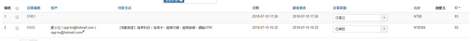

Payment Method: Credit. Paid Failed, Exception(Unknown column 'payment_access' in 'where clause').
I using "AllPay" that is 8rd product for payment plugin in Taiwan
www.ecpay.com.tw/Service/Appcntr_Shpcar
Order will change two
Set up an order
a blank order
The contents of the blank order are:

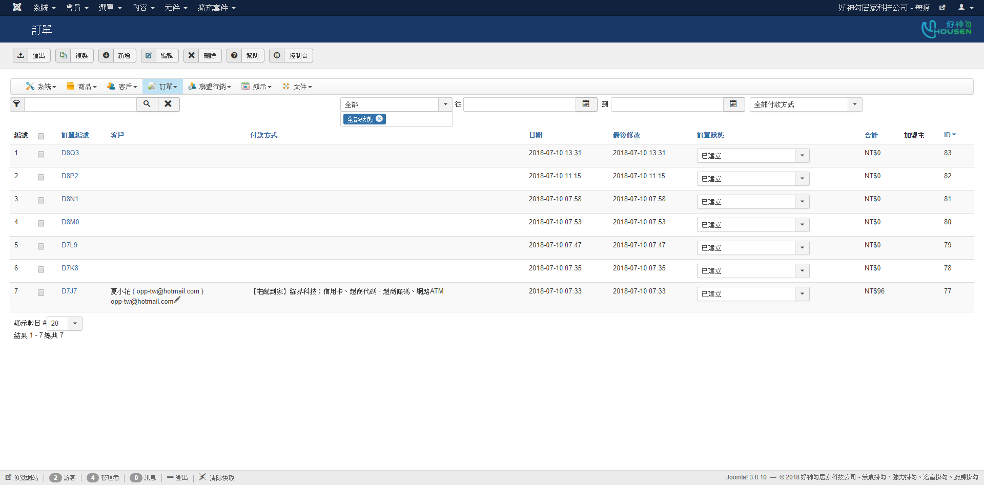

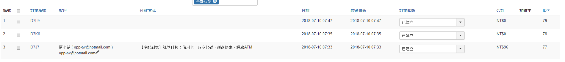

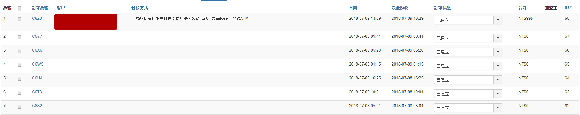

  • Posts: 26
7 years 10 months ago #295017
Just tested again
After the order is established
Display a bunch of blank orders

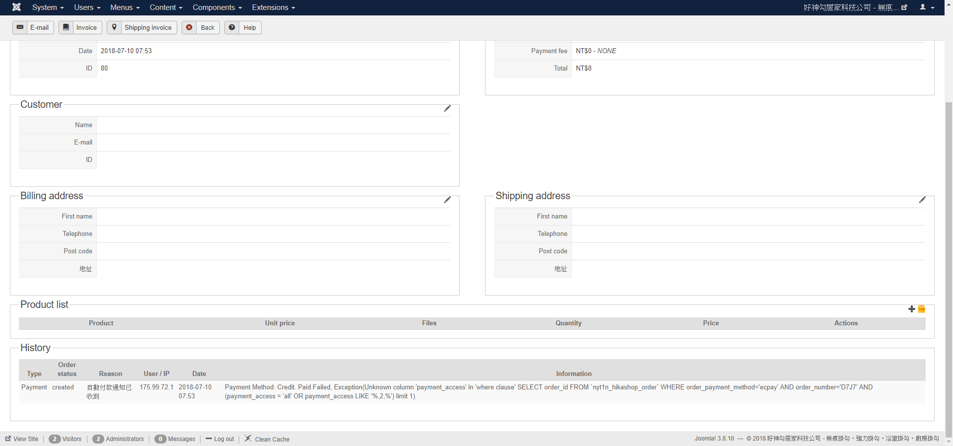

  • Posts: 26
7 years 10 months ago #295097
I reinstalled the payment kit
After successful payment
The blank order is: Payment Method: Credit. Paid Failed, Exception(Unknown column 'payment_access' in 'where clause' SELECT order_id FROM `nyt1n_hikashop_order` WHERE order_payment_method='ecpay' AND order_number='D7J7' AND (payment_access = 'all' OR Payment_access LIKE '%,2,%') limit 1).

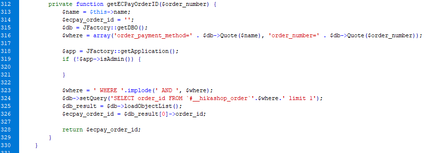

7 years 10 months ago #295108
That's a bug from your payment plugin. I've reported the issue to the developer here:
github.com/ECPay/HikaShop_PHP/issues/1
As a quick fix, you can remove the line :
hikashop_addACLFilters($where, 'payment_access');
in the file plugins/hikashop/ecpay/ecpay.php on line 320.
And then reinstall the payment plugin when the developer provides a new version with a proper patch.

  • Posts: 26
7 years 10 months ago #295125
One hour ago
Deleted
but...
Just received again
Last edit: 7 years 10 months ago by wwwopptwcom.

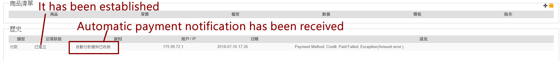

The same is the old problem
Modify plugins / hikashop / ecpay / ecpay.php
after that...
There will be a blank order
Order display

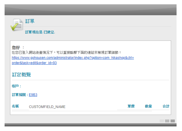

From:
Payment Method: Credit. Paid Failed, Exception(Unknown column 'payment_access' in 'where clause' SELECT order_id FROM `nyt1n_hikashop_order` WHERE order_payment_method='ecpay' AND order_number='D7J7' AND (payment_access = 'all' OR Payment_access LIKE '% , 2,%') limit 1).
change
Payment Method: Credit. Paid Failed, Exception(Amount error.)
Currently in order not to generate a blank order
Have deleted the previously successful order
Will no longer receive blank order notifications and create
