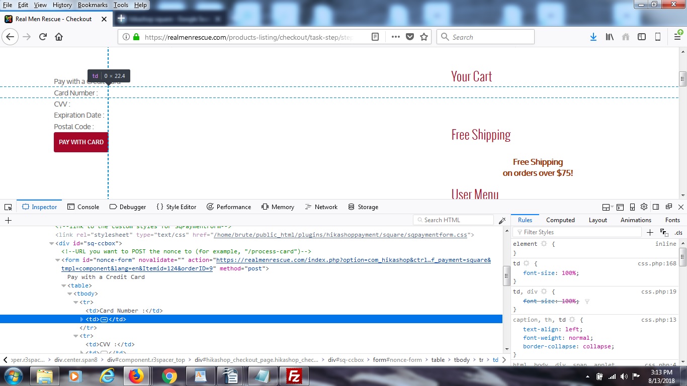

Plugin successfully installed on HikaShop Starter: 3.5.1. but dead check-out dead ends on payment page.
The ID, Token and Location information has been entered. However the form does not have input fields to gather the information; please see screen shot.
The installed version of the plugin was re-downloaded today 8/13/18.
I am assuming the plugin works with the Starter so what am I missing? All check out, cart and payment template customization has been removed.
Your support would be greatly appreciated...the needs to go public by end of week...(this is in conjunction with an event that is out of my control.
Thank you!

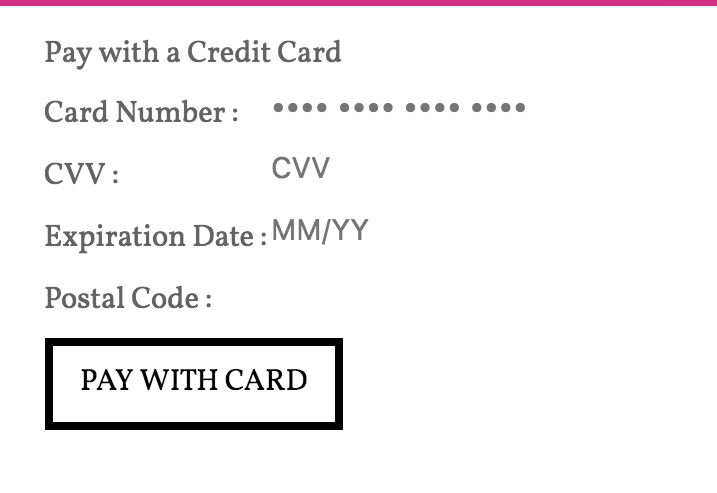

  • Posts: 25
7 years 8 months ago #298668
I disabled the postal code requirement and now there is default text in the fields, but they are still not editable. See attachment. I will send you a PM for access to the back end.
  • Posts: 145
  • Thank you received: 35
7 years 8 months ago #298672
I wasn't able to access your website as I'm having an empty page using the link your provided.
Can you do another test and :
- press "F12" through the credit card page
- Click on the "Console" tab
- Show us a screenshot of information displayed through that tab
Note that Square will also require a website using the HTTPS protocol and can't work without it.

  • Posts: 145
7 years 8 months ago #298694
I just tested it end was able to edit these fields, can you test it again ?
Also, we just improved the Square payment plugin, can you re-download it using the link that was sent to you by email or though your customer space on Hikashop website and test it again ? Thank you.

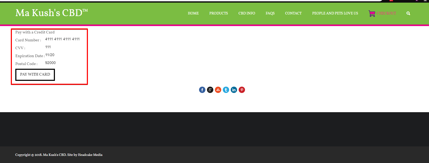

  • Posts: 25
7 years 8 months ago #298716
I installed the updated app and I can enter information now. I think I may have been just typing in random keys before, and the only information the fields accept is numbers. Typing letters shows nothing.
Thanks Tsuki, I know this is a newly developed plugin. Is it possible in the future to have the rest of the shopping cart info that HikaShop offers on the page as well? Having a blank page with only card information fields look suspicious and not very legitimate. Someplace to put the Square identification would let buyers know this is a safe transaction.
