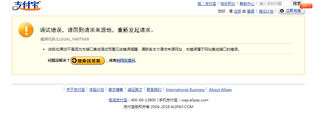

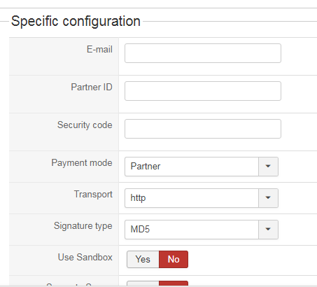

Dear support,
I have a question that is how to configure the Alipay payment plugin in Hikashop. When I check out the product with Alipay, the page shows an error; I attached the screenshot for reference. The error code is ILLEGAL_PARTNER.
I don't know how to configure it at the back-end. Can you help me?
Thanks in advance
7 years 7 months ago #299055
The plugin doesn't seem to be compatible with their partner mode, you should set the "Payment mode" option to Direct and test it again.

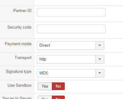

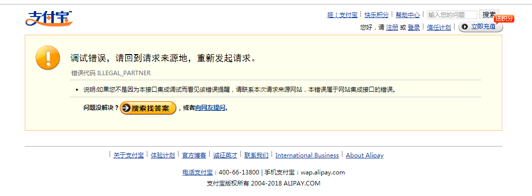

7 years 7 months ago #299100
I changed the Payment mode to "Direct," but the same error appeared during checkout. Did I miss some information? I didn't enter any information in the "Specific configuration" area. How do I solve this?

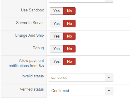

7 years 7 months ago #299115
Can you also try it with the "Server to server" option set to YES and test it again ? If it's still not working, then you should probably directly contact the Alipay support regarding that error message to know if it's coming from your credentials.

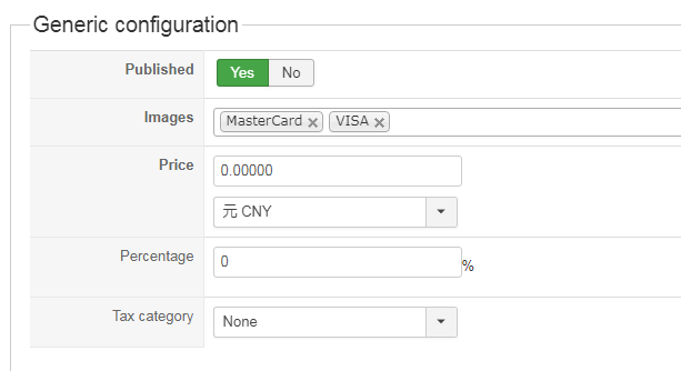

5 years 6 months ago #326445
Hello Quinn,
they let me asking you: if your Alipay interface is in the following list:1. create_forex_trade 2, create_forex_trade_wap 3. mobile.securitypay.pay ?
If you want to test the Alipay plugin and check it's configuration interface, you can check it using our demo website (username: demo / password: demo) :
demo.hikashop.com/administrator/index.ph...nt_edit&payment_id=5
Also, we have a "30-day money-back guarantee" policy, so you'll just have to contact us about it using our contact form if needed :
