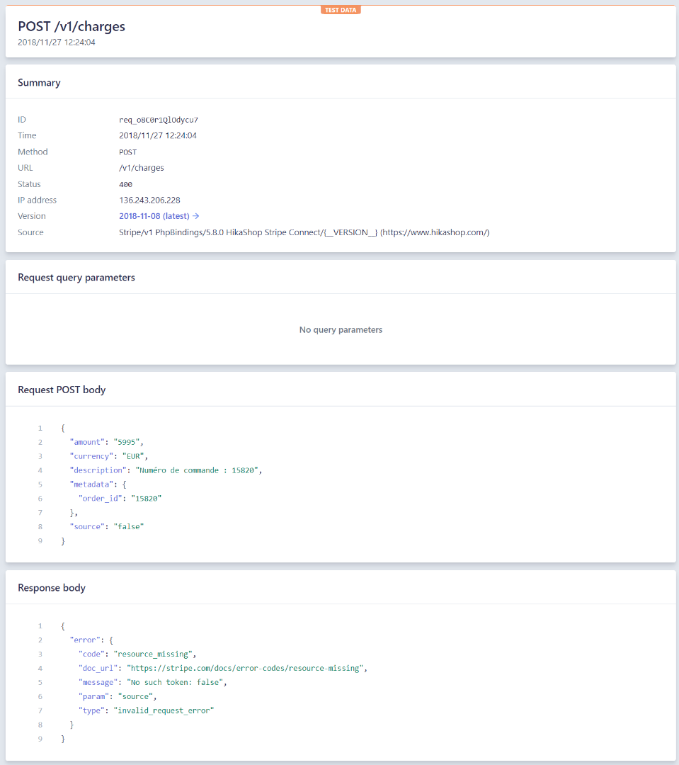

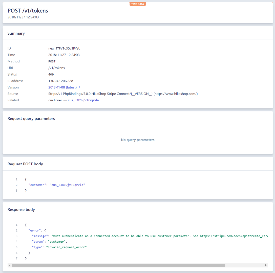

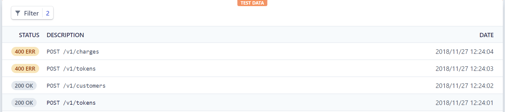

I was also getting this error and I saw your post, so now I updated the plugin and the error is different now.
The order gets cancelled, and in the Stripe Log I can see that both POST/ v1/Tokens and POST / v1/Charges fail with error 400.
Her is the Stripe log response for the Tokens:
  "error": {
    "message": "Must authenticate as a connected account to be able to use customer parameter. See https://stripe.com/docs/api#create_card_token for more details.",
    "param": "customer",
    "type": "invalid_request_error"
I hope it helps.

  • Posts: 26380
7 years 8 months ago #300967
Please re-download the HikashopPayment Stripe Connect plugin.
It looks like you're using the "preferred charge" in "direct" mode but, without a vendor, the result is not a good one.
I change the algorithm in order to not use the "direct" charge when there is no vendor ; it should avoid your issue.
