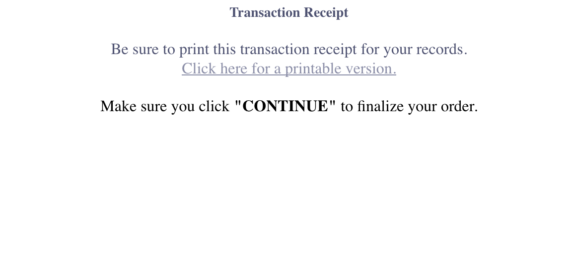

I am using a payment gateway that does not have a plugin for HikaShop. They do, however, use the same sort of credentials as Authorize.net and have directions to modify the settings needed for Authorize.net to work with their system. I have used the Authorize.net API plugin and entered the credentials they need to make it work for their system with the exception of one thing: the return URL.
I have been on the phone for a few hours with the payment gateway (NMI) troubleshooting this issue. After a successful payment processing, you are brought to a page that gives you the option to print your receipt or "click CONTINUE to finish the transaction". The problem is there is no CONTINUE button! The gateway help said this is simply a link back to the website. There is a place in the Authorize.net plugin to add a return URL but for some reason that information is not being brought over to NMI. They are saying that information just isn't coming through like the rest of the information.
Why am I on the forums to check this? Because the Authorize.net plugin seems to have a bug. When I first set up the plugin to connect to NMI, I entered DEMO credentials to test the system. When I changed those credentials to the real thing, the DEMO credentials kept coming through along WITH the real credentials. It couldn't let go. I had to start a new API and start with the real credentials to get past that glitch.
I can't have shoppers think there is one more step that they are not completing. The sale works, the payment is taken, but they are left thinking there is more to do.

Nicholas, it looks like I need to modify the Authorize.net API to work with NMI. They apparently are missing the "x_relay_url" parameter and are looking for it to be "url_finish" (or "x_url_finish") but I don't know where in the code to change that. I also am not sure which file that code is in. It seems like a simple change that I can do, I just want to make sure I replace the right code.

That did the trick Nicolas! "url_finish" worked as opposed to "x_url_finish"
The return URL button did not actually show up, but I was able to add some basic html to the thank you message to make it a link back to the site. Not perfect or pretty but it works.
