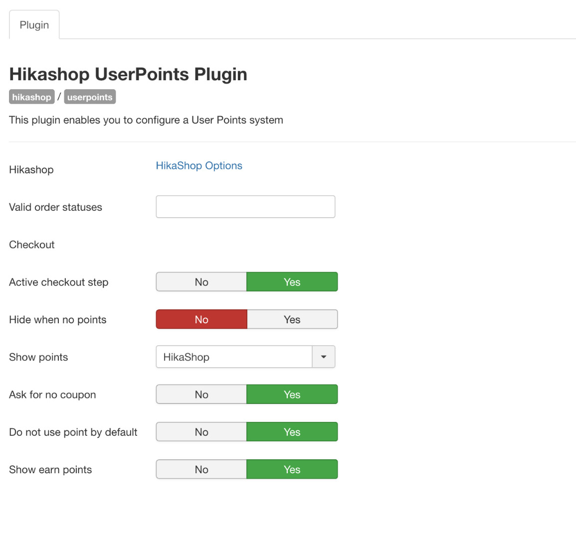

2. There is already a view you can use in your checkout workflow for that. In the settings of the user points plugin via the Joomla plugins manager, you have options to have a checkout view. Then, you can add that view to your checkout workflow.
With the settings of the plugin, you can manage what the view will display.
can you please tell me what view? this is my configuration i dont see any options for the view

2 - You have the "active checkout step" so it means that you that "checkout step" available in your checkout workflow configuration.
