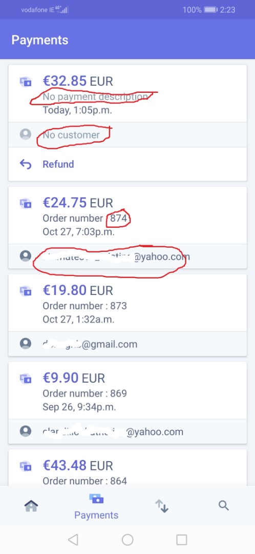

6 years 10 months ago #312582
Regarding the suggestion "Modifying the following function of your plugin should do the job" to add order number and email to the description sent to Stripe....
I am not a developer so I wonder if anyone can direct me to the exact place to add the code?
See attached screenprint how it is working for me today. It is really difficult to reconcile the payments when you are only relying on the amount.
Niamh

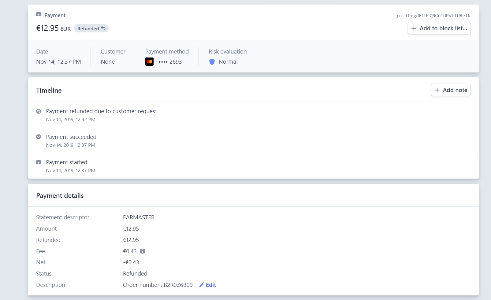

  • Posts: 135
6 years 10 months ago #313089
institutcalysta wrote: Hello nmanek,
1) Extract the downloaded plugin zip file to a folder.
2) It should contain several files, including the "stripeconnect.php" file. The function to modify starts at line 714 in the current version of the plugin, best is to search with a text editor for "private function createPaymentIntent(&$dbOrder, $payment_method_id)".
3) Now patch the function like indicated in my post and save the file.
4) Create a new plugin zip file from the whole content (including the subfolders, like "language", "lib" and "media").
5) Install your "homemade" plugin zip file as usual.
A warning, because you wrote that you are not (yet) a developer. A small mistake when patching the PHP file, or forgetting to re-create a plugin ZIP file with the original folder structure including all the original files will probably break the plugin. Probably, in case you may just reinstall the original plugin, which should fix the issue and you can try again, but you might just as well break admin access to your Joomla backend. So please, try this on your test server first and have a backup.
Best regards
Alexander
P.S.: I am just a user like you helping you for free, so please don't blame me, if something goes wrong. On the other hand, if you get it to work on your site, you will feel very proud of yourself. :-)
Just wanted to confirm that this has also worked for us. Thanks a lot Alexander, and thanks of course Jerome for making the plugin.
The "Customer" field is still blank though. It used to be populated by the customer email with version 1.0.0. I'm not sure why it's gone, but hopefully it'll be back with the next update of the plugin :)
