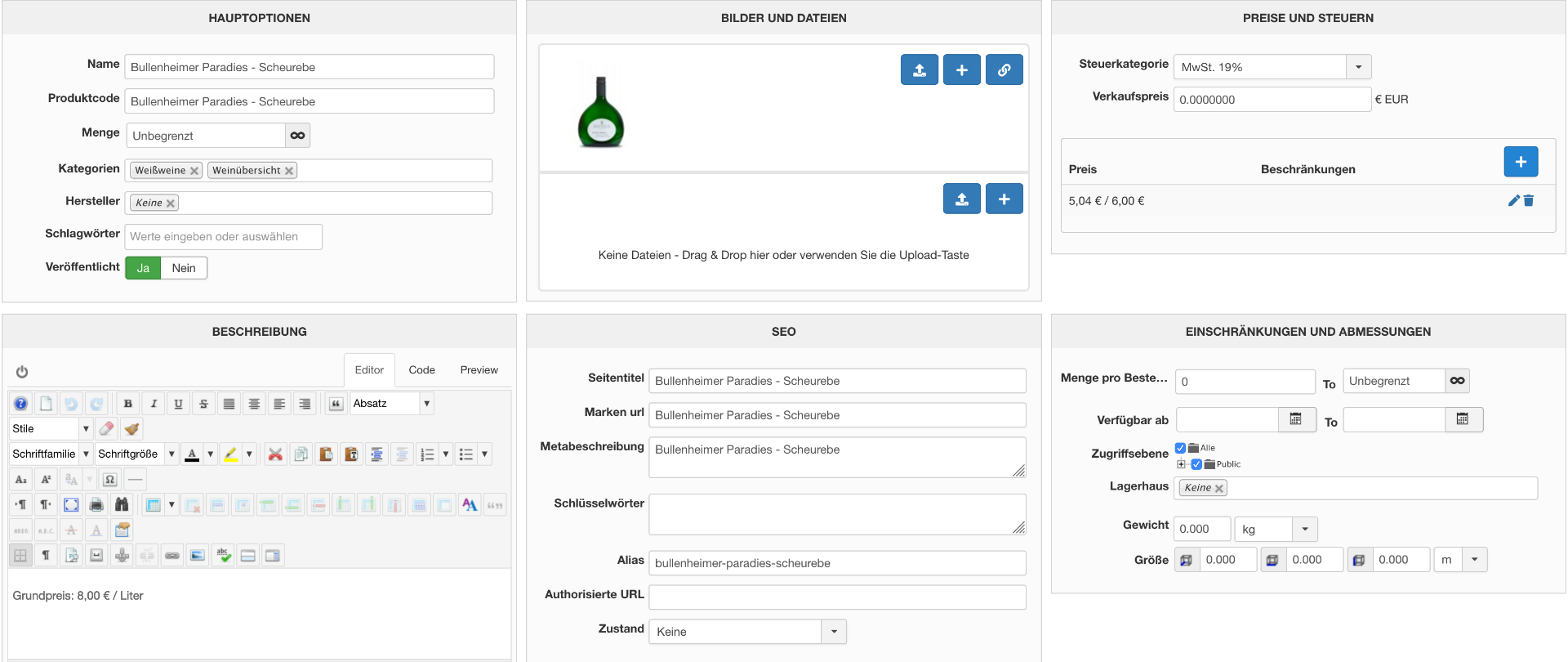

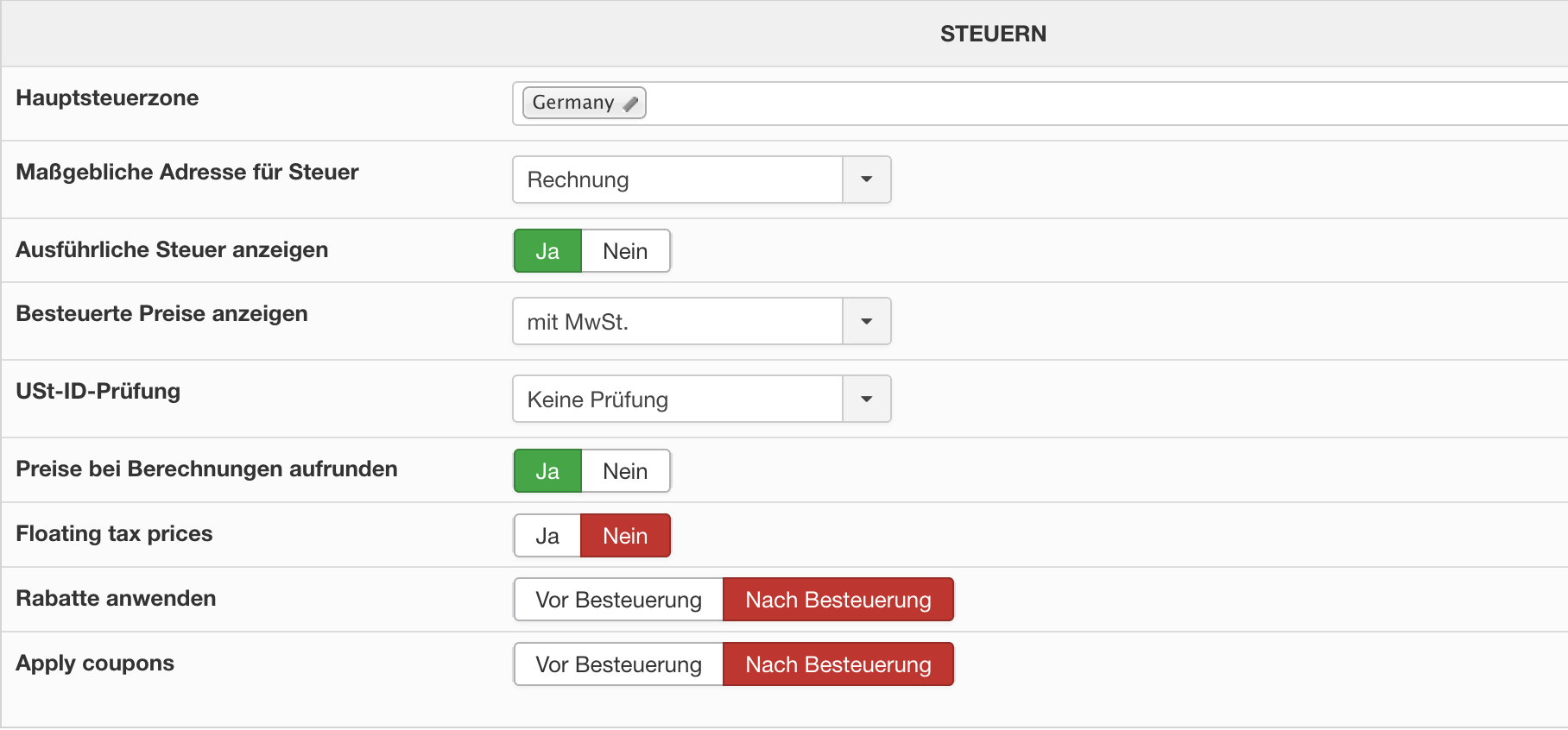

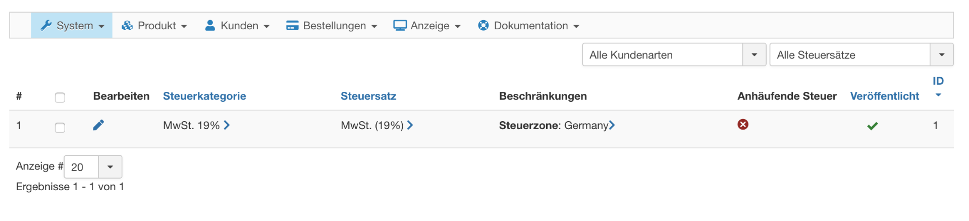

  • Posts: 10
  • Hikashop Essential
7 years 4 months ago #305598
Hey Nicolas,
thank you for your reply.
As an attachement I send you the screenshots.
Last edit: 7 years 4 months ago by roblex.

7 years 4 months ago #305607
The result you get is normal.
I suppose that you've entered 5.04 as the price without taxes of your product.
5.04 * 10 = 50.40 price without taxes for 10 pieces of your product
50.40 * 1.19 = 59.98 price with taxes for 10 prices of your product
Instead, enter the value 5.04202 for the prices without taxes of your product. And I think you want to turn off the "round prices during calculations" setting so that the amounts are not rounded during the calculations.
That way, you'll have instead:
5.04202 * 10 = 50.42 price without taxes for 10 pieces of your product
50.4202 * 1.19 = 60 price with taxes for 10 prices of your product
