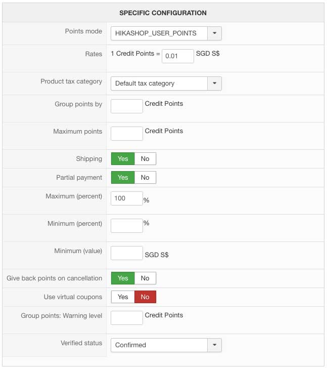

All working fine and as intended if a customer uses his points to partially pay for his order: a coupon gets (auto-)applied, showing in the "footer" of the order in order details, invoice and email, correctly reducing the total amount.
Not so if a customer pays an order in full with points.

3. When you pay in full with a payment method, be it the user points payment method or another one, it just records the payment method in the order/invoice.
If you don't want to have it appear like that, you can change the "use virtual coupon" setting in your payment method and make sure that you have the user points view added to your checkout workflow in the HikaShop configuration. In that case, the points will be added as "additional fee" to the cart, not as a payment method.

7 years 4 months ago #306269
I still think you want to look at the "vritual coupon" setting.
The user points view on the checkout will have an option to allow you to use your points or not as long as the "ask for no coupon" setting is activated in the plugin (which is the case, looking at your screenshots).
Changing the code in the plugin like you did would bypass the normal flow of the code and thus you dive in untested grounds. So of course, unexpected problems would happen. I don't recommend going that way.
