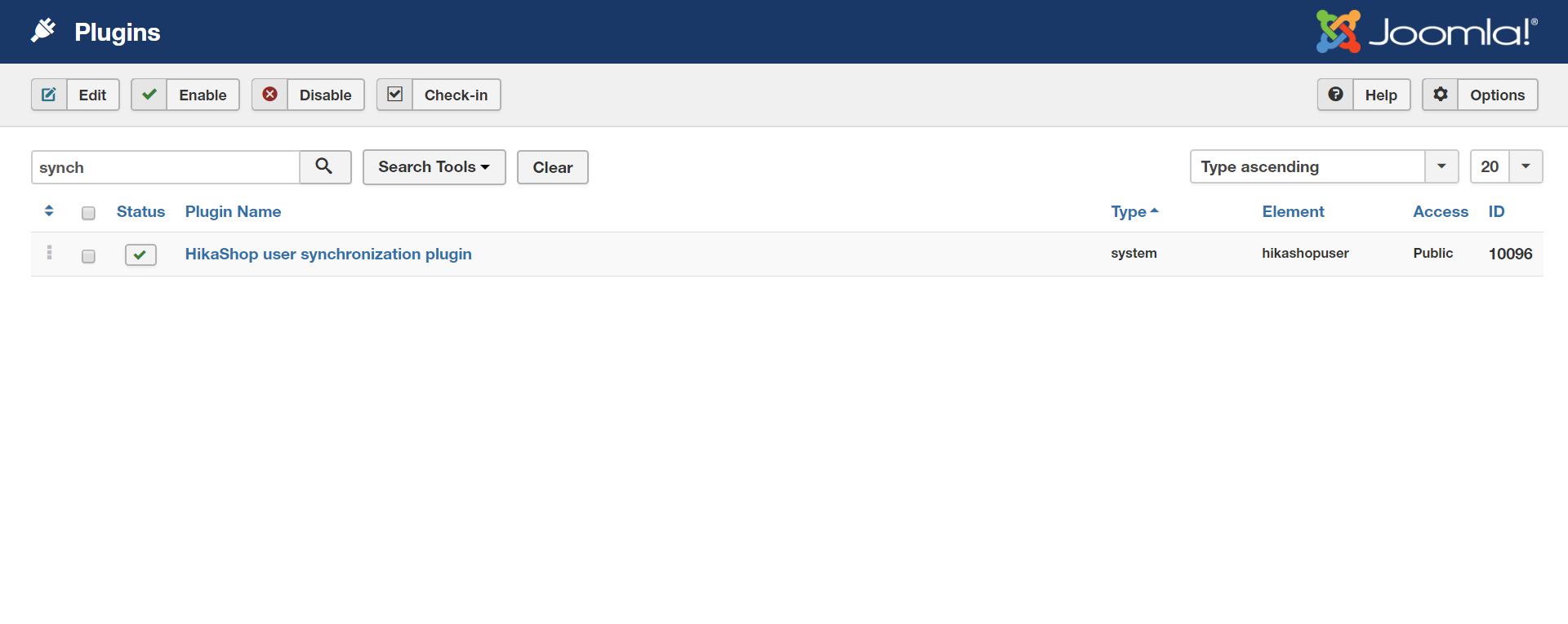

Hi Nicolas
I have just checked the admin area and that plugin is showing and is activated.
So not sure why you got the error!
Dave

7 years 2 months ago #307310
Well, I don't know what happened but I don't have the error no that I'm looking at it and I indeed to see the plugin.
So I'm suspecting something happened in the mean time.
Maybe it's an intermittent error (and that would explain why you're not able to reproduce the problem).
I actually am not able to reproduce the blank page issue on your frontend now.
However, when I looked earlier today, I couldn't even finish the checkout (I think it was linked to the plugin missing).
So maybe the problem is fixed for that person too ?
Maybe it's something linked to caching of pages, or a CDN which goes in between the users and the website ?
