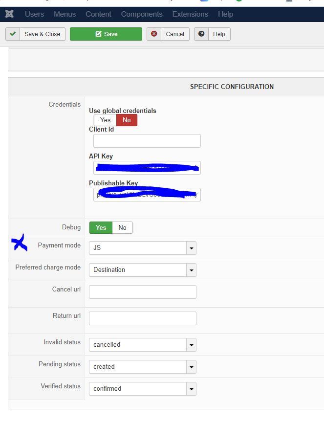

6 years 2 months ago #316897
Regarding your screenshot, you do not have the "Payment interface" parameters which means that you're not using the latest version of the plugin but an old one.
You have to download the latest version of the plugin via your HikaShop order.

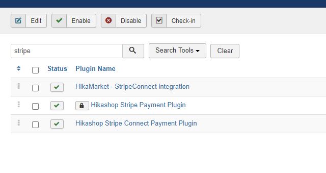

5 years 10 months ago #322343
It looks like the plugin is working :
pasteboard.co/Jjuma1a.png
  • Posts: 60
5 years 10 months ago #322355
Hi Jerome
It shows up yes, but I am unable to amend the settings as per your instruction in the thread.
hese are the required settings :
Global credentials : No
Client ID : (empty, just need for the Stripe Connect integration)
Api Key: your API key
Publishable Key : Your key
Debug : Yes or No (depending if you want to have some debug data in the HikaShop payment log or not)
Payment mode : end page
Payment interface : Card (3D Secure)
ie only option for Payment mode is JS and there is no field for Payment interface. See attached snapshot.
Can you please tell me exactly where I can find the set up sections. I have uploaded the files, they show in Extensions - Plugins
After that I am unsure -- I have gone to Components - HikaShop - Config - System - Payment Methods - Created New - though not sure how this then connects to the new V3 SCA plugin and as you can see the fields don't show

5 years 10 months ago #322379
I don't know how you have installed/updated it in your website but indeed, you're not up to date.
To be sure, I checked the repository but it's not possible to download an old version of the plugin, only the last one is available.
But I would suggest you to check the files via FTP to check if they are not "read only" and maybe upload them manually.
Unfortunately, if the file is read-only, the installation will not be able to update the files and something, without displaying an error or warning message.
