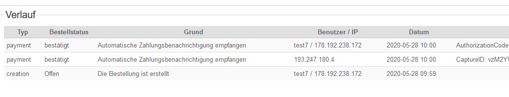

Then, I would recommend to check the "history" area of an order with the issue.
There is logged each modification of an order. If you see two emails in the Customer>Emails history listing for the order, it's highly likely that you'll see two lines of confirmation of the order by the payment plugin. This will indicate that the payment plugin has been called twice by the payment gateway to notify it of the payment (this can happen if he doesn't reply adequately the first time). And in that case, what that means is that the plugin should have some failsafe to not confirm an order that is already confirmed.
So you'll have to check with the developer of the plugin regarding that. Maybe they actually have a new version of the plugin and you just need to update it ?

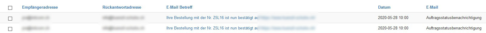

I did a lot of testing with developer of Saferpay Plugin (webit.bz). I got new version of Plugin. Problem is not solved. The developer said:
It should not be a problem of the plugin, as it does not send any (success) email anymore.
In email history and order history I have double entries of emails (please see screenshots).
Any idea of how to solve the problem?
Thanks.
