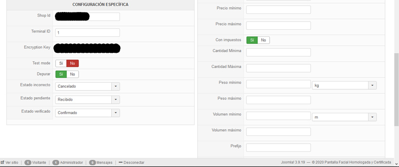

  • Posts: 6
5 years 11 months ago #321056
We're getting the same problem (exactly the same) with credit card payment (the only one we use). System was working fine. Suddlenly this issue started.
Orders are created without any problem.Confirmation email is sent. Credit card payment is done also fine. BUT, when coming back to the shop from the credit card processing page, the order status is not updated to confirmed and no update status email is sent.
We didn't made any change neither website, neither Hikashop configuration.
Best Regards
Sergio

  • Posts: 85712
  • Thank you received: 14048
5 years 11 months ago #321091
@theguy : I would recommend to activate the "debug" setting of your payment methods and clean first your "payment log file" (you can see its path on the configuration page under the Files area; just change its name to start anew).
Then, when the payment plugins receive notifications from the payment gateway, they will add data to that payment log file, which will allow us to understand why the order is not being confirmed.
@sergio_aname : I see you already have the "debug" setting turned on in your payment method. So please check the content of that payment log file. Ideally, if you can provide it via email that would be great. You can send the email to contact AT hikashop DOT com
Make sure you include a link to this thread. And if the file is big, I would recommend to use a file sharing website like send.firefox.com/
  • Posts: 6
5 years 11 months ago #321105
Hello Nicolas,
Thanks for your answer. We didn't see anything wrong on the log file but we will send it to you. It's small since we activated the debug system trying to find a clue of the problem.
BR
Sergio

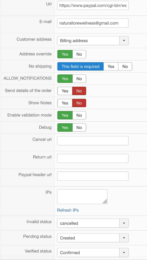

  • Posts: 29
5 years 9 months ago #323339
I am having same issues with PAYPAL payments we are testing live payment and status is staying on "created" . I ordered using my personal PAYPAl account and in my account Payments are flagged as "pending". Interesting that in the payment plugin settings the "Allow Notifications" setting is displayed like this ALLOW_NOTIFICATIONS. We have just updated to latest version of Hikashop Business currently this is stopping us moving forward and taking orders.
Re dubug - I'm unsure how to set debug on payments - do I need to apply this for the whole site under Joomla config or is there a setting I'm missing?
  • Posts: 29
5 years 9 months ago #323341
I Found debug mode and did another test payment - log as follows - note that notification and verification ARE turned on in Paypal plugin settings:

  • Posts: 85712
5 years 9 months ago #323351
If the payment is pending on your PayPal account, it probably means that you have the "enable validation mode" setting activated in the PayPal payment method setting page in HikaShop, or that same setting activated on your PayPal merchant account.
That setting allows you to manually validate the payments on your merchant account before confirming the order.
