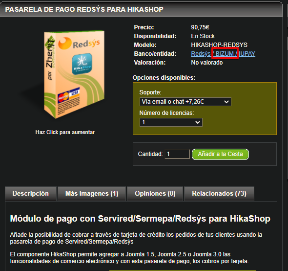

5 years 10 months ago #325079
Hola.
He visto este plugin pero si lees la descripción del mismo no pone que tenga la opción de Bizum configurada.
Un saludo!!
5 years 10 months ago #325113
I think it will be best to directly ask them as "Bizum" is actually stipulated in their product page.
Kind regards,
Mohamed
Last edit: 5 years 10 months ago by Mohamed Thelji.
