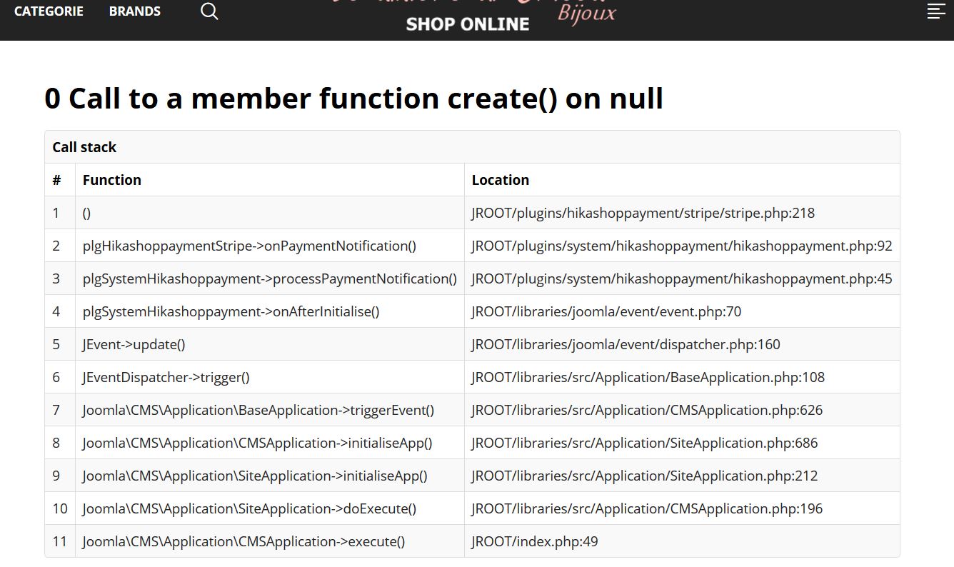

  • Posts: 18
5 years 9 months ago #325376
Thank you for fast answer.
In attachment the screenshot of debug mode.
  • Posts: 86027
  • Thank you received: 14171
5 years 9 months ago #325408
Please note that you're using the legacy Stripe plugin which isn't supported anymore. On Stripe's end too, the API this plugin uses isn't SCA compliant and the API is supposed to be discontinued already.
To use Stripe, you need to use this plugin which is the only current and supported solution for Stripe and HikaShop:
www.hikashop.com/marketplace/product/133...nect-by-obsidev.html
The following user(s) said Thank You: Baracus
