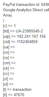

However, with direct call turned on and the above code is uncommented, the transaction data in google analytics lacks all session info. Since customer doesn't need to redirect back to website, transaction data is sent automatically when payment notification is sent from paypal to website. Two weird things happen:
1. If UTM parameters are specified, everything is logged properly.
2. If UTM parameters are not specified, the session info from the __utmz cookie is not sent properly with the transaction. I'm not sure why this would not break, but it seems to be related to using the __utmz cookie info in the direct call. Perhaps the __utmz cookie parameters aren't being used properly in the googleDirectCall function?
If the __utmz cookie hypothesis doesn't explain the issue, I'm all out of ideas... Is there a way to see the full array sent to Google Analytics when transaction is complete? If the result is empty fields for the case where UTM parameters are not specified in the URL, that would confirm that the __utmz params are not being pulled into the direct call method?

However, in the case of no UTM tracking parameters in the URL, a packet with empty values for session info was being sent to google analytics:
Therefore, if I comment out the campaign specific information, all tracking in google analytics works perfectly (since nothing is overwritten) and all transaction show up now since the customer does not have to redirect back to the website. I kept wondering why everything looked fine before and after payment, but the transaction itself had the wrong campaign/session info. I will continue to monitor over the next 24 hours to make sure everything is logging correctly before closing this issue on my end.
