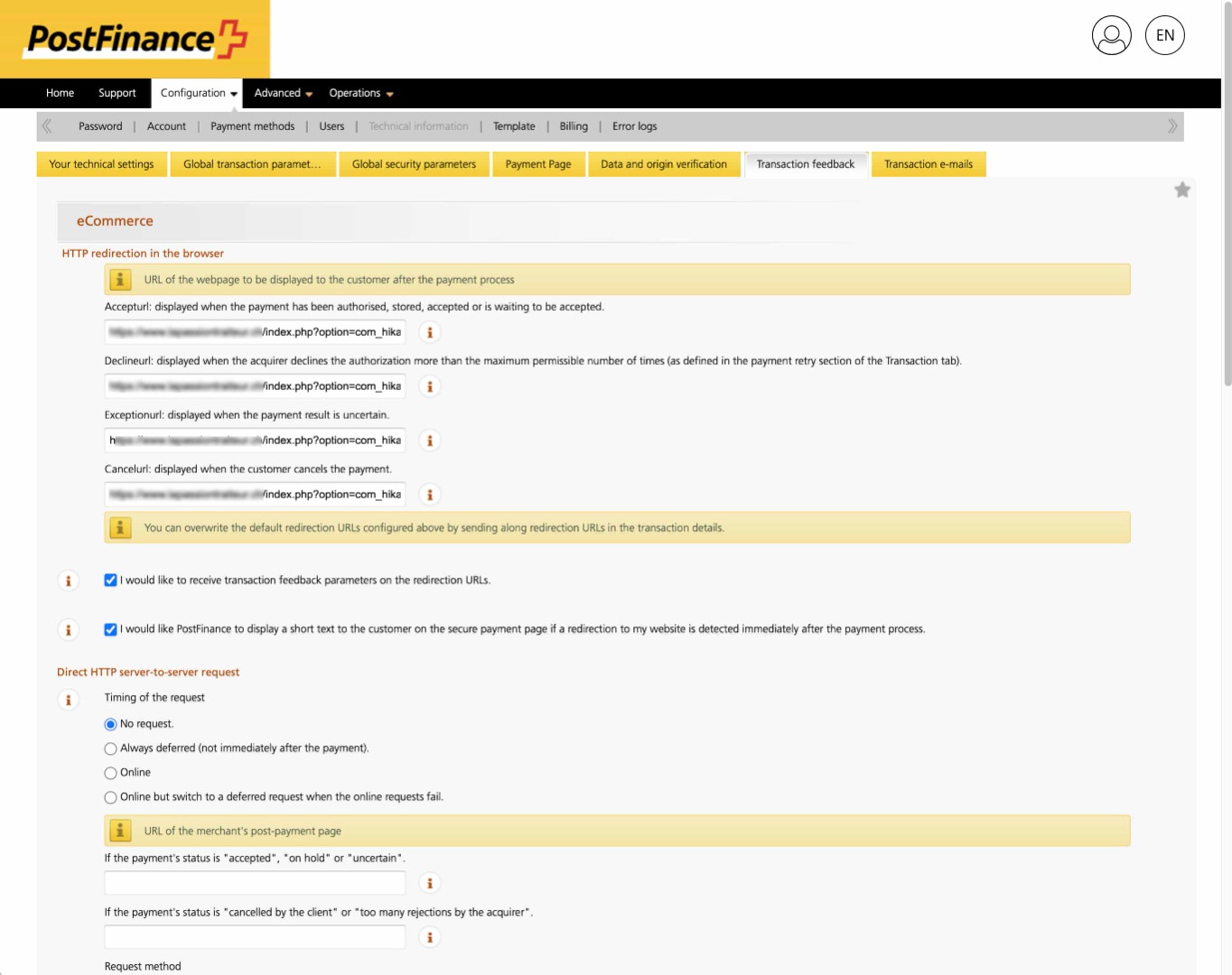

-- url of the page with the problem -- : www.hikashop.com/support/documentation/3...e-configuration.html
-- Joomla version -- : 3.9.23
-- PHP version -- : 7.3
Hi !
I have problems to change my order status after Postfinance payment.
My first question is about the Hikashop Postfinance documentation page :
Under "TransactionFeedback" > "AcceptURL" & "DeclineURL" & "ExceptionURL" & "CancelURL" seems to use the same URL address :
(You'll have to set it to the notify URL that can be found through the "Return url" option of your Hikashop PostFinance payment method)
Is that what it is, 4x the same URL?

1. Yes, you need to set the same URL for all of these settings. That's because in all the cases, it's the same function of the plugin that will deal with the result, and based on the transaction information returned by PostFinance, it will confirm the order and display the thank you page, or cancel the order and redirect back to the checkout.

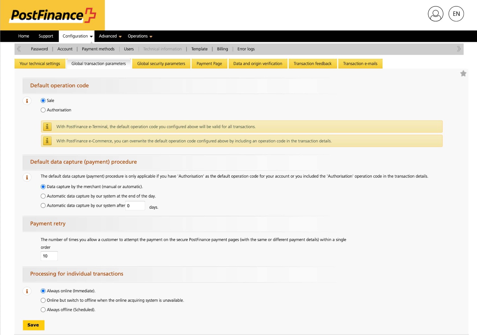

As I still have some problems with transaction returns from Postfinance, I have other questions about your postfinance module documentation page:
3. You do not show an illustration of the "Global transaction parameter". Must the "Default opération code" be "Sale" or "Authentication"? (I'am on "Authentication"…
4. Do you have an advice who are you looking for my mistake?
The transaction works but the status is not updated when the customer returns to the shop.

patrick.chappuis wrote: 3. You do not show an illustration of the "Global transaction parameter". Must the "Default opération code" be "Sale" or "Authentication"? (I'am on "Authentication"…
Yes I'm talking about your documentation page :
Then the "Global transaction parameter" > "Default opération code" must be on "Sale" for Hikashop.
This solve my problem!

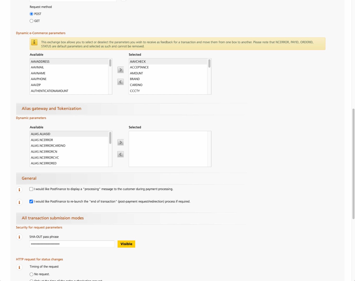

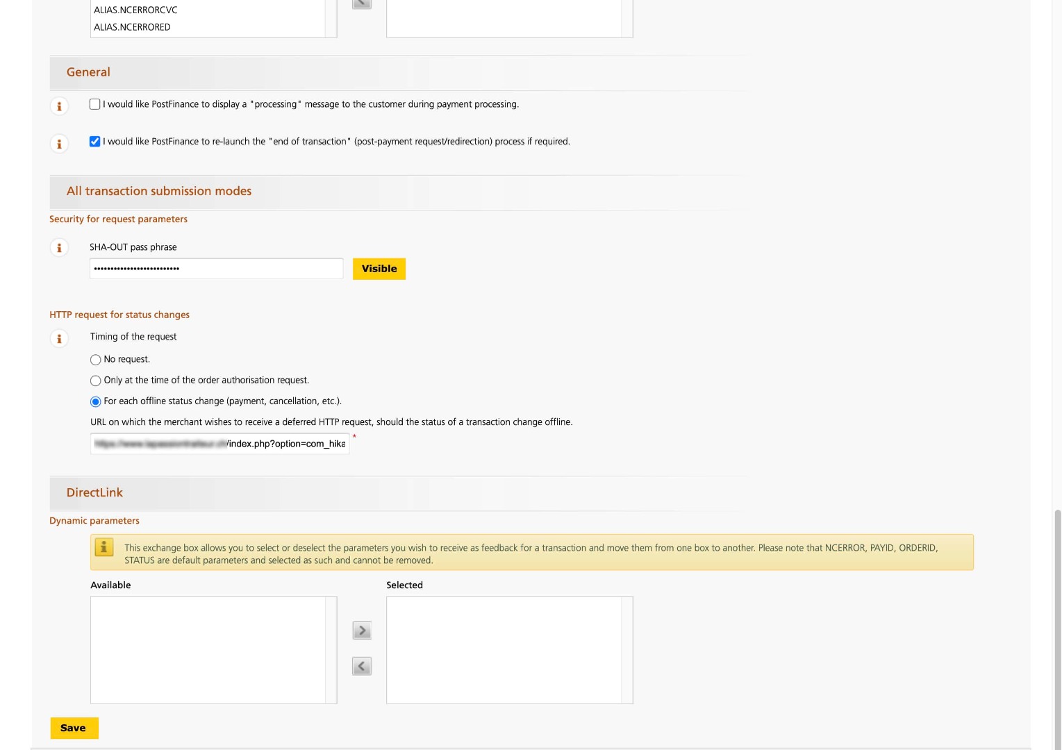

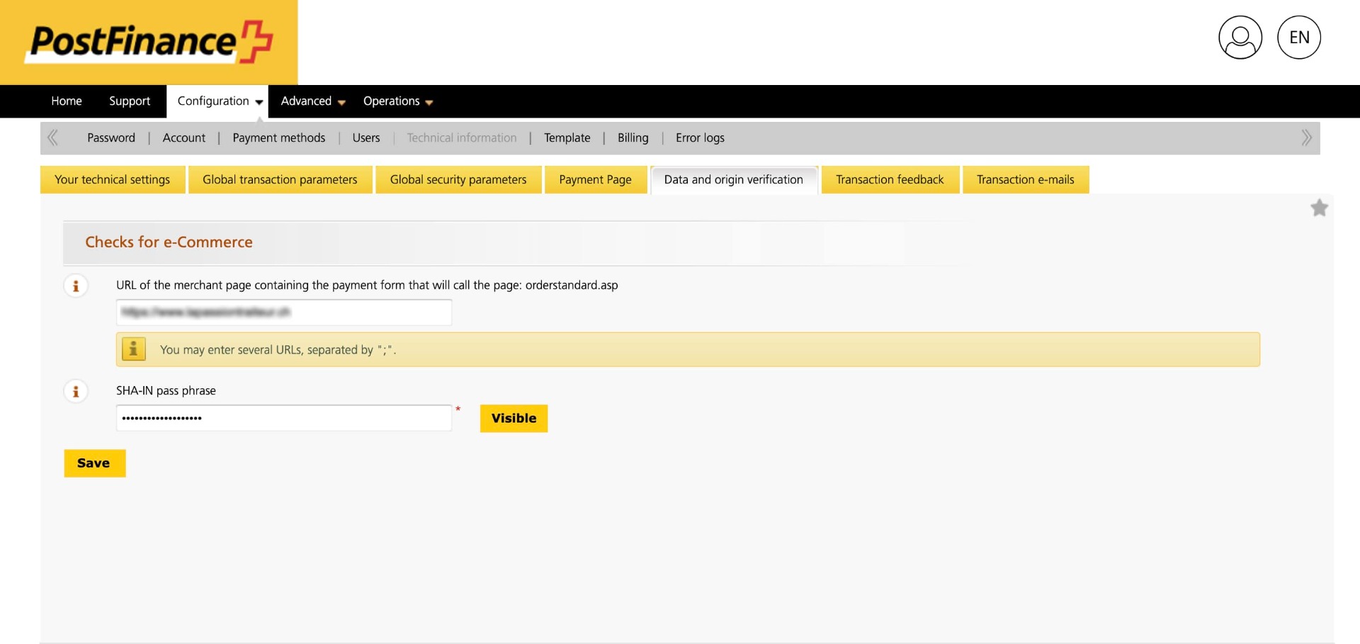

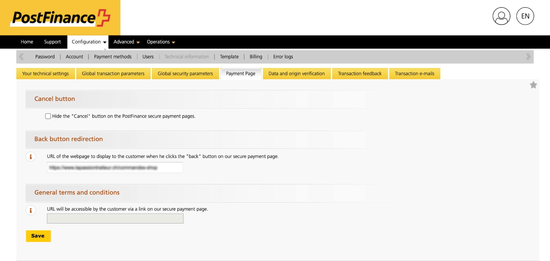

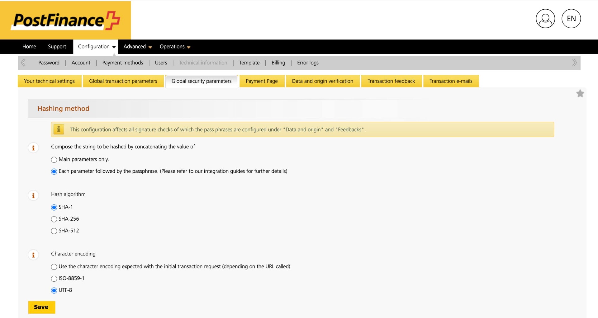

For your convenience I made print screens of the current Postfinance interface (dec.2020) with blurred sensitive data. This way you can update the illustrations on your Postfinance page which is very important for us HikaShop users in Switzerland.
Regards & Merry Christmas
Patrick
5 years 8 months ago #327836
A big thank you for your screenshot, this will allow us to save time while updating our documentation !
Thanks for the support !
