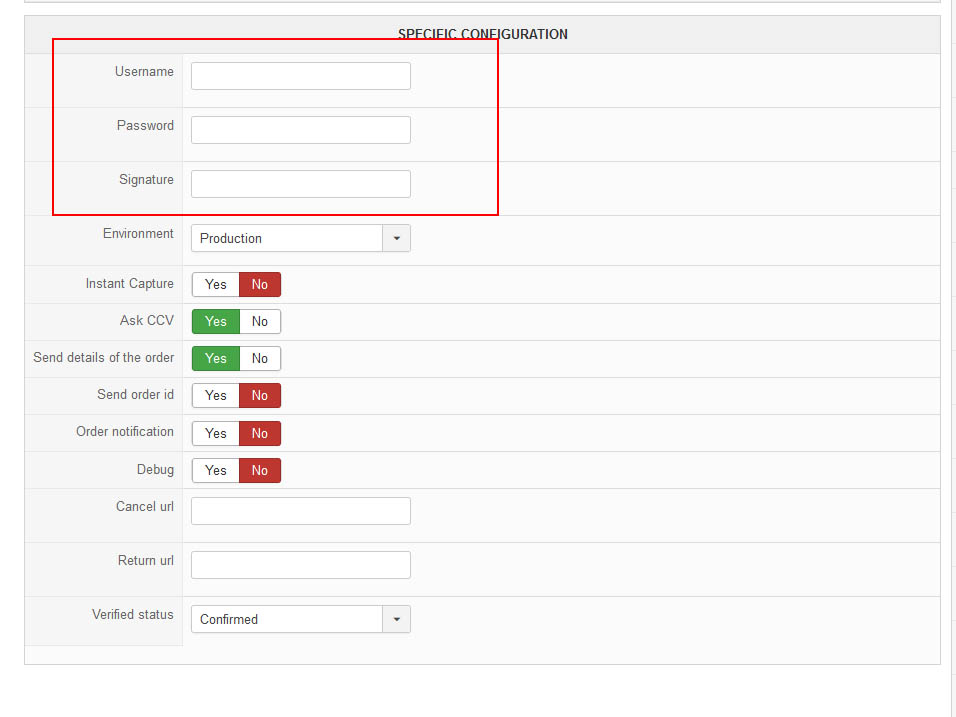

We would also like to do this but I'm having real trouble trying to figure out what needs to be set up at the Paypal end. Are there any Paypal experts here, or someone who has got it working who can help?
The Paypal Pro payment plug in (within Hikashop) is asking for Username, Password and Signature. What are they?? It can't possibly be wanting us to enter the Paypal username and password...

Here is the help for PayPal's documentation to get your credentials for the Payflow pro api used by the PayPal pro plugin:
www.paypal.com/us/smarthelp/article/how-...s-pro-account-ts1944
And here is the documentation for PayPal Advanced (only the beginning is needed:
developer.paypal.com/docs/payflow/gs-ppa-hosted-pages/

5 years 4 months ago #330582
I have got Paypal Pro working BUT although the orders are being confirmed, the confirmation email is not being sent to the customer. This is quite a big problem.
I have tested several times and I receive the order created email but no confirmation once the payment has been processed.
On the admin side everything seems OK, 2 emails are received and the order shows up as confirmed. Please could you check this out for me.

Regarding PayPal Pro, note that HikaShop sends two emails to the customer by default:
- the "order creation notification" sent to the customer when the order is created
- the "order status notification" sent to the customer when the order status is changed from "created" to "confirmed" by the payment plugin after the payment notification.
So with PayPal normal, your customers will get two emails and with PayPal Pro, your customers will only get the first one as the order is directly created confirmed.
What's likely is that you disabled the "order creation notification" so that your customers would only receive the second email for PayPal standard and thus it means no email sent for PayPal Pro.
Also, note that in a previous screenshot of yours, you had the "order notification" setting turned off in the PayPal Pro payment method settings page, you probably want to turn that on.
