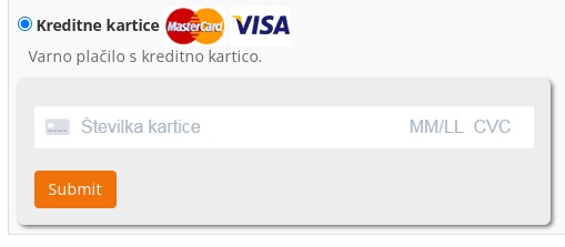

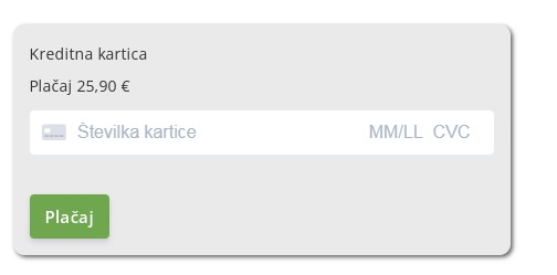

  • Posts: 430
  • Thank you received: 22
3 years 9 months ago #345649
I manage to somehow design the look.
But submit button cant be translated.
This is end page mode and translation is working.
  • Posts: 26380
3 years 9 months ago #345650
Regarding your screenshot, that orange button is the HikaShop checkout payment button.
So it's using the "HIKA_SUBMIT" translation.
For more details see the view : checkout / show_block_payment
