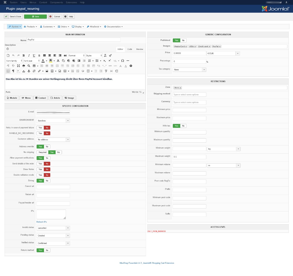

Hi, we currently have a bit of trouble with the PayPal Recurring Payment Plugin.
We use HikaSerial to generate serial numbers and we also use it for subscriptions. When a user wants to buy a subscription, he needs to use the recurring payment plugin for PayPal. Of course everything is in sandbox mode, since the shop isn't open yet.
The checkout process works up to the point where the payment needs to be confirmed. PayPal accepts the subscription and tranfers the money. But it cannot confirm the successful transaction to hikashop. The order can't be confirmed and the subscription stays closed. I enabled the debug mode for the plugin and get some "404 ROUTE_NOT_FOUND" errors at the end.
The weird thing is, that this only happens for the recurring payment plugin. We also offer other products without an attached subscription and use the basic PayPal Plugin for them, which works just fine. And the settings for both plugins are pretty much identical.
Sometimes I also get the following error:
Deprecated: Function get_magic_quotes_gpc() is deprecated in /plugins/hikashoppayment/paypal_recurring/paypal_recurring.php on line 770
