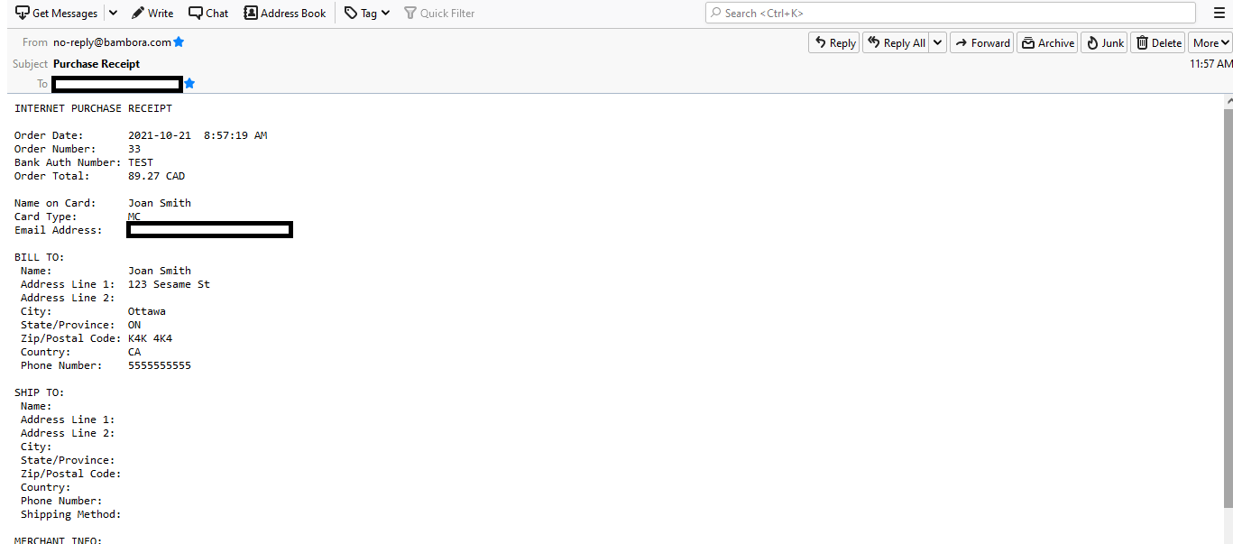

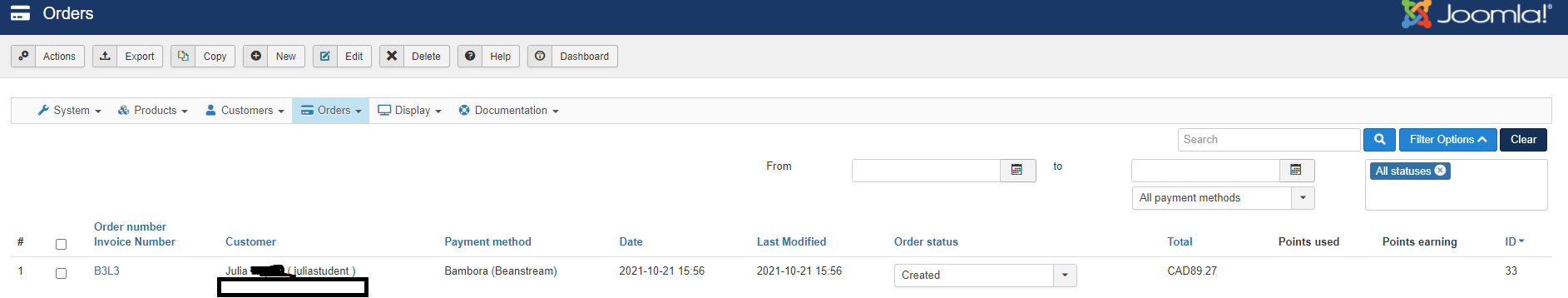

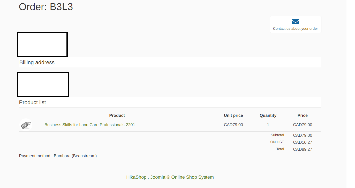

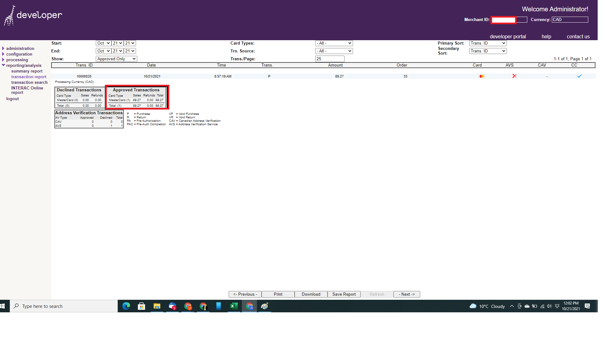

The cart is only available for registered users so I'm attaching a number of screenshots including the confirmed order the user sees on the front end, the approved order in Bambora, the order status in HikaShop, the purchase receipt the user and the admin receive. We have HikaShop settings specifying that an order be updated to confirmed once payment is confirmed; or pending if payment is declined but neither is happening.
The plugin we're using is Bambora/Beanstream, they are one company (and now rebranded as Worldwide). If the plugin isn't working than that's probably our issue and we will have to find an alternative to HikaShop.
We're using a Bambora test account and the url referenced is bambora_params.php. We've been getting error message emails from Bambora (possibly because it's a test account and test card) but the parameters in the error message don't match the parameters in the php file. Everything seems to be going to Bambora without issue but then doesn't get returned.

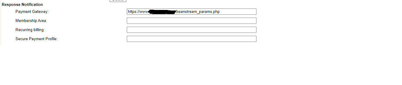

In the administration or configuration interface of your beanstream merchant account, you're supposed to add the URL
https://www.yourwebsite.com/beanstream_params.php
as response notification URL.
Previously, it looked like this:
i.imgur.com/AuSeBvK.png
But the interface might have changed over the years, especially since beanstream became bambora.
The log that you provided indicates that this hasn't been done.
Could you please check on this ?
  • Posts: 6
4 years 10 months ago #336558
Yes, this was added in the initial setup. We also have a beanstream_params_u.php in our file system the same place as the beanstream_params.php file. I don't know where the _u.php file came from.
