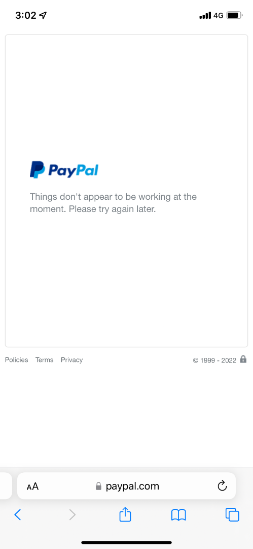

I am not sure if there is an issue with PayPal!
I have a busy site which now has a number of orders that have been created but not paid when using PayPal. Stripe payments are being processed. In some cases there are multiple orders from the same person and I have asked the client to contact them to raise a query.
I have now attached a screenshot. When the customer carried out a purchase he get the message as per the attached.
This is now quite urgent as they have a number of clients using PayPal!
Are the Developers aware of any PayPal issues?

That's a generic error so hard to say anything.
It works fine on our end so I don't know why this is happening. Did something change on that website ? Like for example, someone changed the settings of the PayPal payment plugin ? Or of the address custom fields (if some fields required for the address are missing because they were disabled, then it could lead to such an error for example) ?
Also, I would recommend contacting the PayPal merchant tech support to inquire about this error. They should have more information about the problem in their logs.
