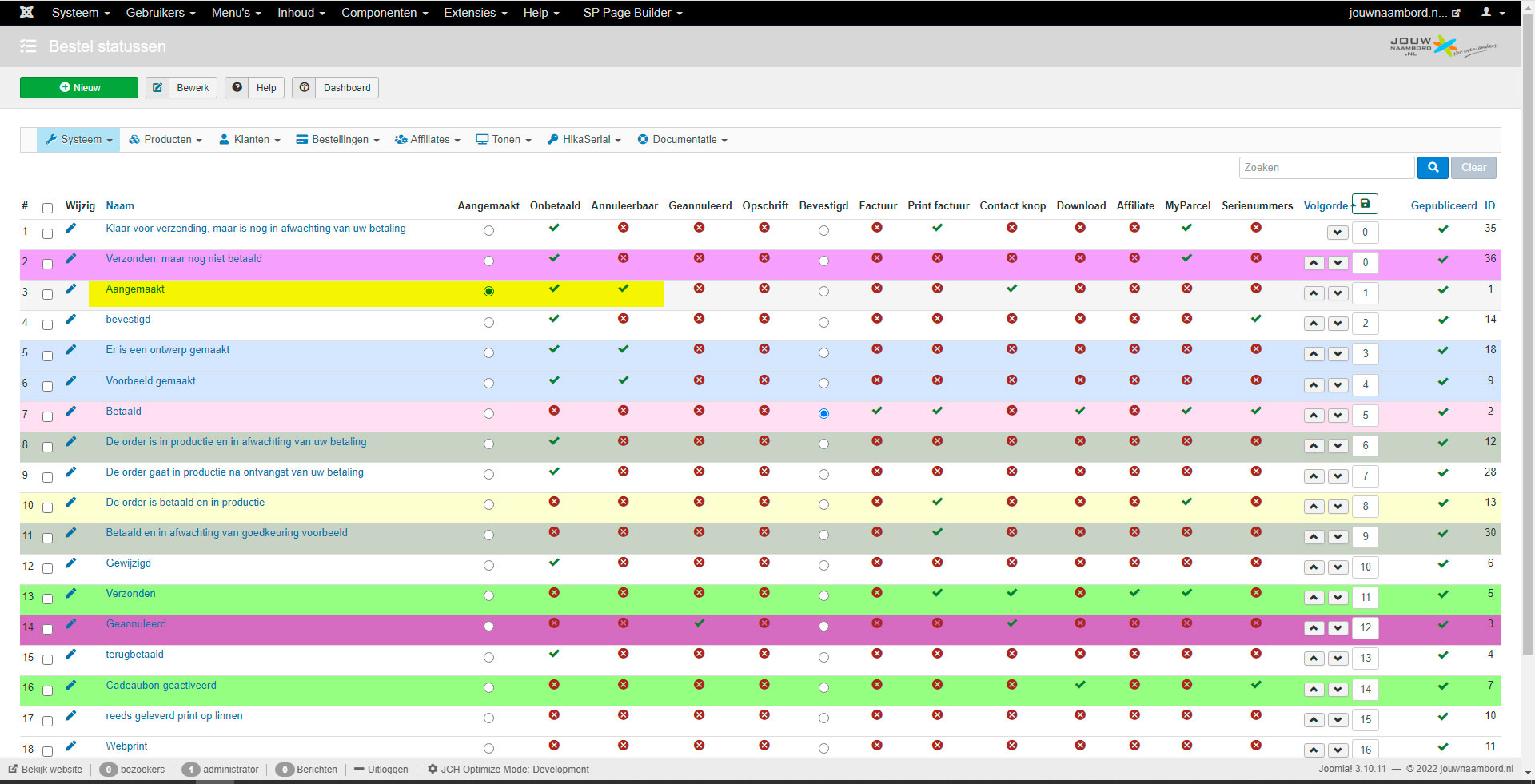

So I'm surprised you're asking this because it should already be the case without doing anything as long as you properly activated the "Payment of orders not paid immediately" setting of the HikaShop configuration and enabled the statuses for which you want to allow the payment under the "unpaid" column of the System>Order statuses menu.

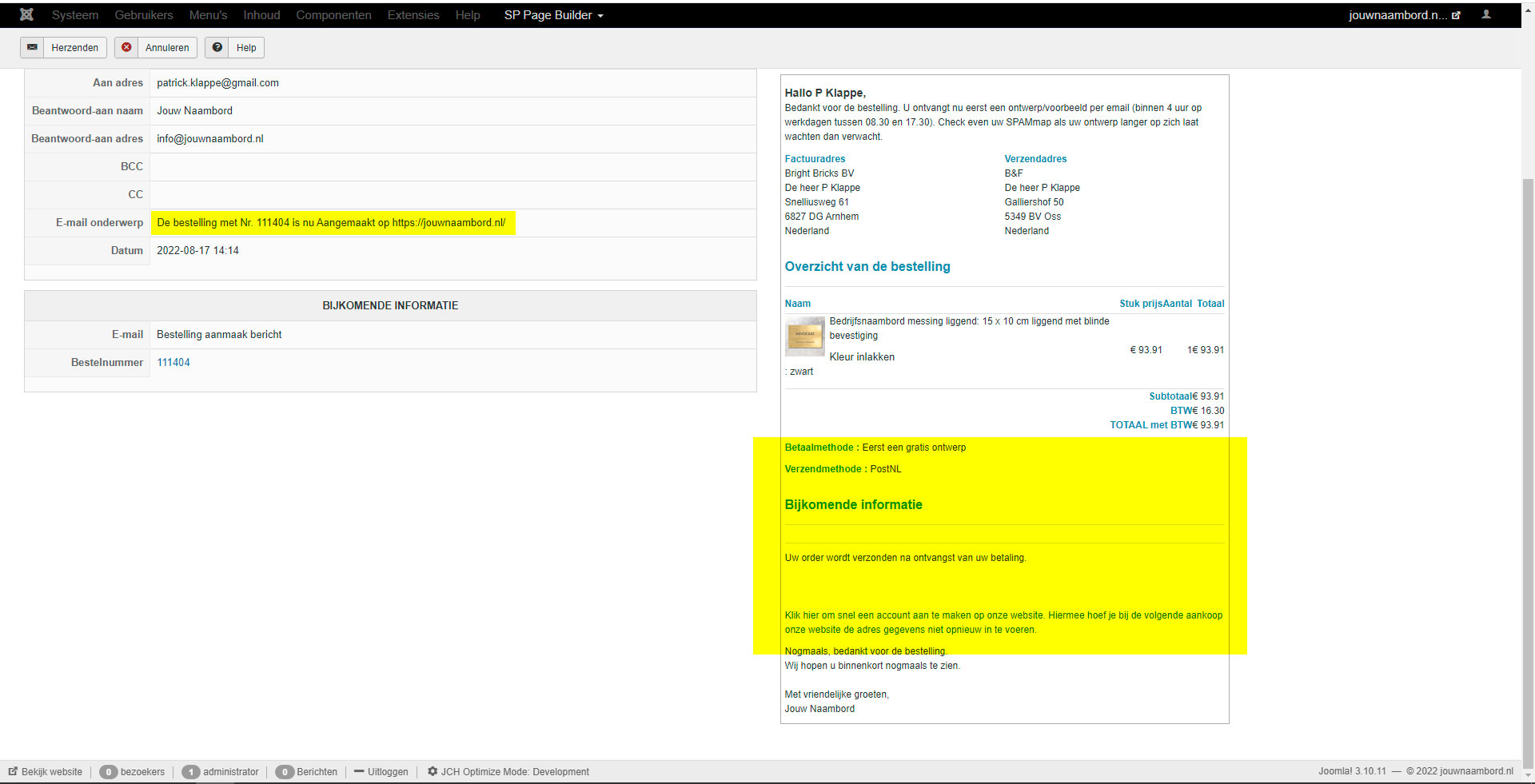

If you click on the "email" button when editing an order, you'll see the payment link at the bottom of the email preview in the popup (and same in the preview of the popup when you change the status of an order from the orders listing), provided the status of the order is enabled as an unpaid status in System>Order statuses.

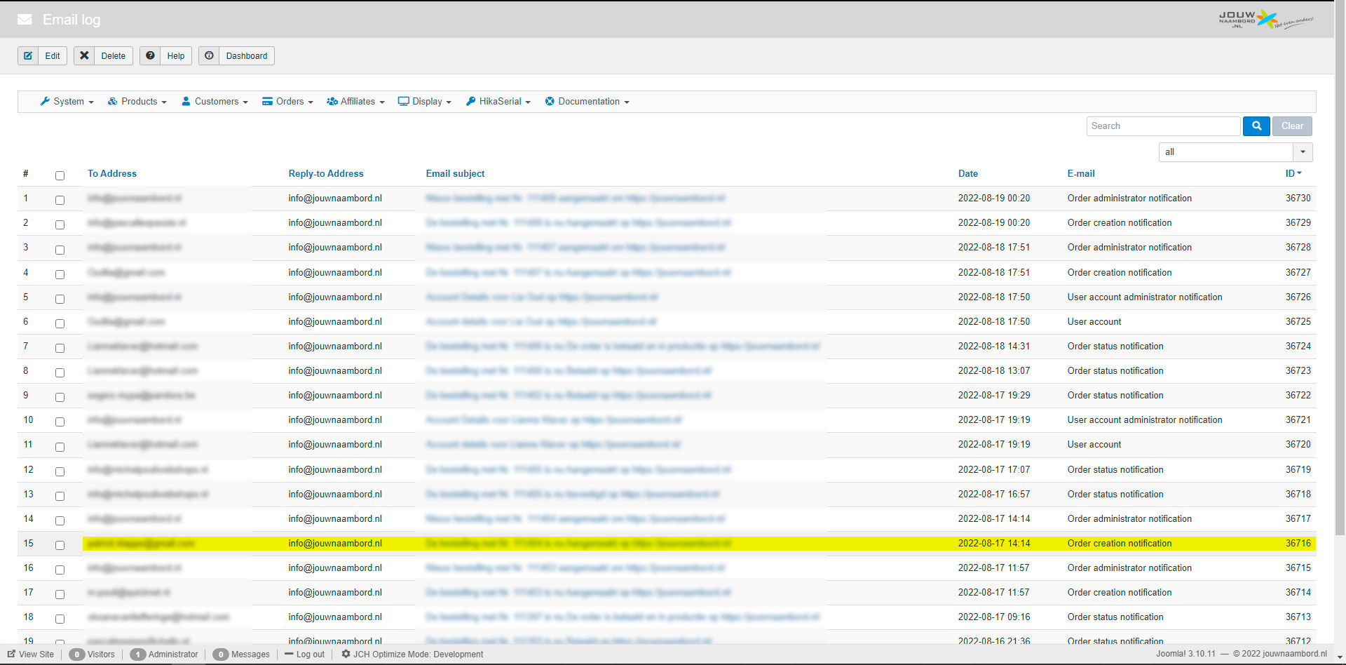

I see the pay now button when clicking on the email button, but when I look into the email history of the system, the auto sended email doen't show the pay now button, see screenshot. Many statuses have the unpaid status enabled, but it seems the sended email doesn't contain the pay now button when using the "notify customer" checkbox.

The email in the screenshot is the email sended from the system after checking the "Notify customer" checkbox in the order edit page. See the screenshot from the email history.

The "order creation notification" email is the one sent to the user when the order is created, not when the "notify customer" checkbox is checked while changing the order status on the order edit page. The email sent at that time is the "order status notification".
So I think you're just not looking at the correct email.

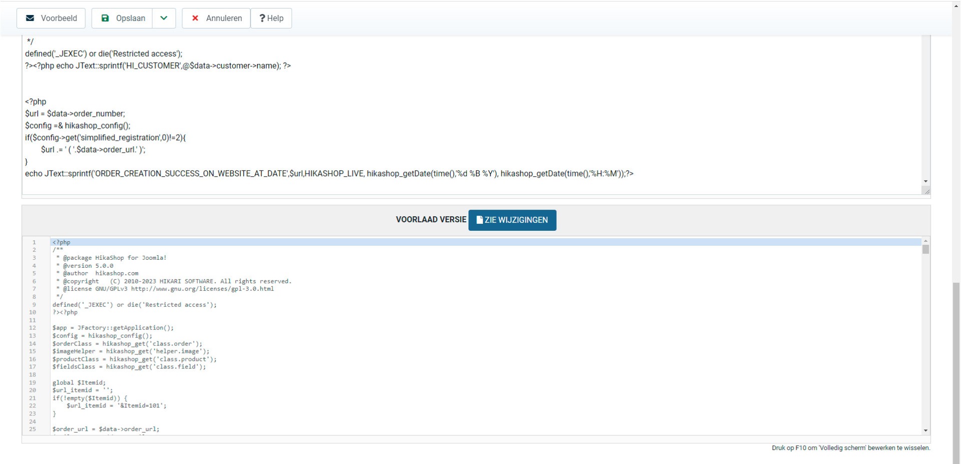

I wanted to say that you should change the whole code:
global $Itemid;
$url_itemid = '';
if(!empty($Itemid)) {
	$url_itemid = '&Itemid=' . $Itemid;
to just:
$url_itemid = '&Itemid=XX';
That's what I meant by "the first part of the code".

I think your issue has several layers to it:
- First, when I checked your customization of the email I saw you used the Itemid 1 and not 101. 1 is the root menu item and should never be used.
- Second, even the 101 menu item is not correct. You need to use a menu item of HikaShop because Joomla's routing system only allows menu items of an extension to display its pages. If you try to use an invalid Itemid like 101 (which is a gantry menu item), HikaShop will auto correct to a random HikaShop menu item (the 544). I've changed it to the 137 menu item but you can choose a better suited menu item.
- It seems that you're doing your tests on the backend and not a real test from the frontend. In order to check which menu items are valid, the system checks that the "access level" of the menu item matches with the user groups assigned to the current user. So if you test the order creation email from the backend, you're logged in as an admin and thus it might not accept the public menu items. Make sure you're testing this change from the frontend by creating an order from the frontend.
