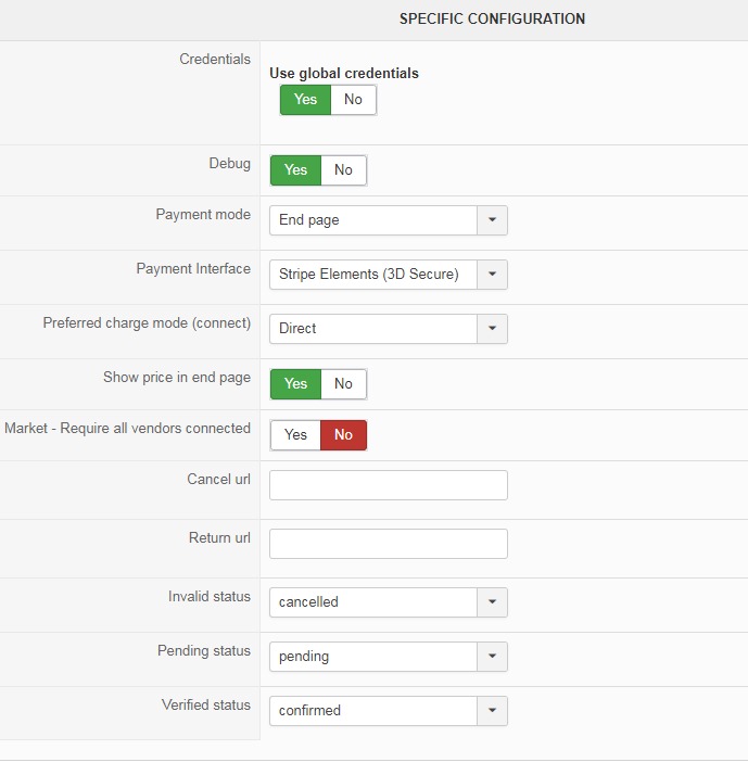

  • Posts: 430
  • Thank you received: 22
3 years 8 months ago #347258
This is config for Stripe plugin.
Orders with problem, get status "created" on order.
  • Posts: 26380
3 years 8 months ago #347287
Since the order is created and we can see some logs in the HikaShop payment log (even if it's a day before) ; it looks like the plugin was working.
Did you changed something ? Did you installed or update another plugin ?
The problem might not be related to Stripe plugin.
You can change the configuration in order to try the "checkout mode" (instead of the "end page" mode) ; so you'll get the Stripe form sooner in your workflow.
But with the current elements and without any access to your website, I'm sorry but I can't say that your problem is caused by the Stripe Plugin.
You could have an HikaShop mass action which is performing some actions when an order is created and gives the customer something similar to a blank page.

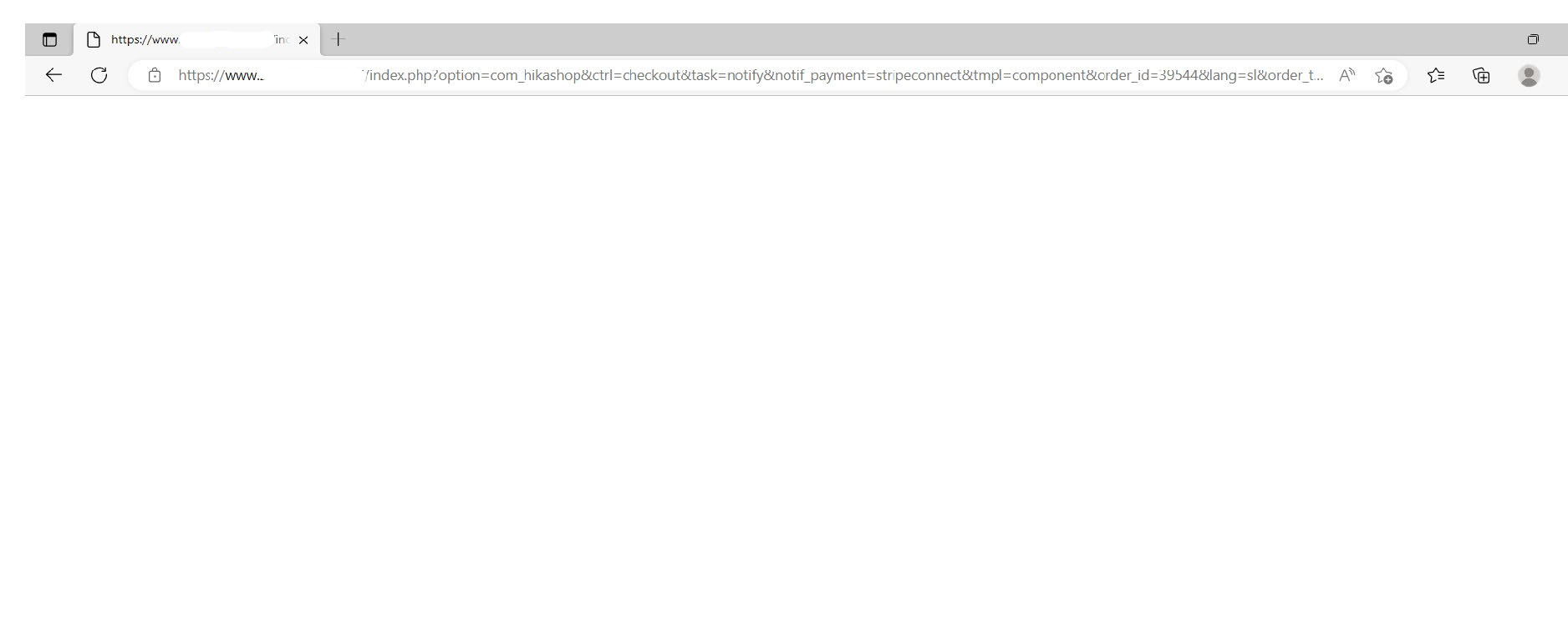

3 years 7 months ago #347425
It is hard to debug with customers. Most of them dont remember or cant expalin.
With some of them, we concluded that they cant enter credit card data becouse there is no form (blank page...).
This is one of them (screenshot).
We try to replicate, but it happens to random. So any address, shipping or coupons can have that problem.
You talk about js conflicts. I notice, that mootols is loading in cart. You can see taht in server log (first atached). I dont know where is that coming from.
  • Posts: 26380
3 years 7 months ago #347442
Can you please check the version of your Stripe Connect plugin ?
The URL you have is related to the "notify" URL ; but the Stripe Connect plugin is just using Ajax calls using JavaScript.
Since the payment form does have the notify URL as target, it looks like your custom has JavaScript issues and somehow submitting the form (but I would need to understand how since the button in the form is not a submit button).
