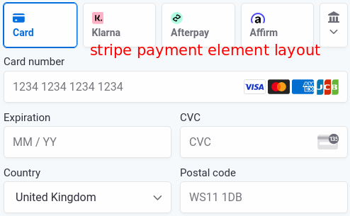

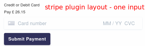

Does it have the ability for any of the following:
- Separate input boxes instead of all the boxes in one
- redirecting to the hosted Stripe payment page instead of the on-site boxes
- Google pay / apple pay

1 - You can override the plugin view and tweak the display according to the "Stripe Elements" documentation.
2 - No, the plugin only support Stripe JS and not Stripe Checkout (which is a totally different API, not compatible with "Connect" feature).
3 - Google Pay and Apple Pay are now again available via a new API (APIs which come and go). Some tests are under development.

Thanks. Where is the correct location to create the plugin view override?
I have created one at /templates/templatename/html/plg_hikashoppayment_stripeconnect/stripeconnect.php but this does not seem to correct.

The view pages that you can override are : "stripeconnect_end.php", "stripeconnect_end_intent.php" and "stripeconnect_end_3ds.php".
The "end" page is for the legacy token API while the common page is the "end_intent" one.
You can't override "stripeconnect.php" which is the payment plugin code, not a view.
