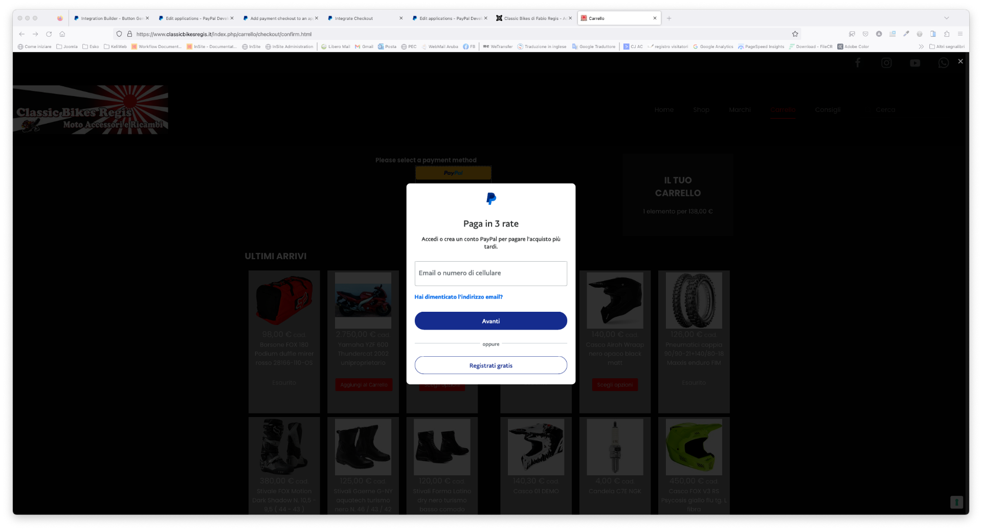

Hi, I configured PayPal Checkout correctly, but when I go to make the payment, a white window popup appears above the paypal window.
this happens both with Cassiopea and with Yootheme, both on desktop and on mobile
you can try it live here: www.classicbikesregis.it/ by simulating a purchase leaving PayPal Checkout as the payment method
I am attaching a screenshot to explain better!
Please,Help me?

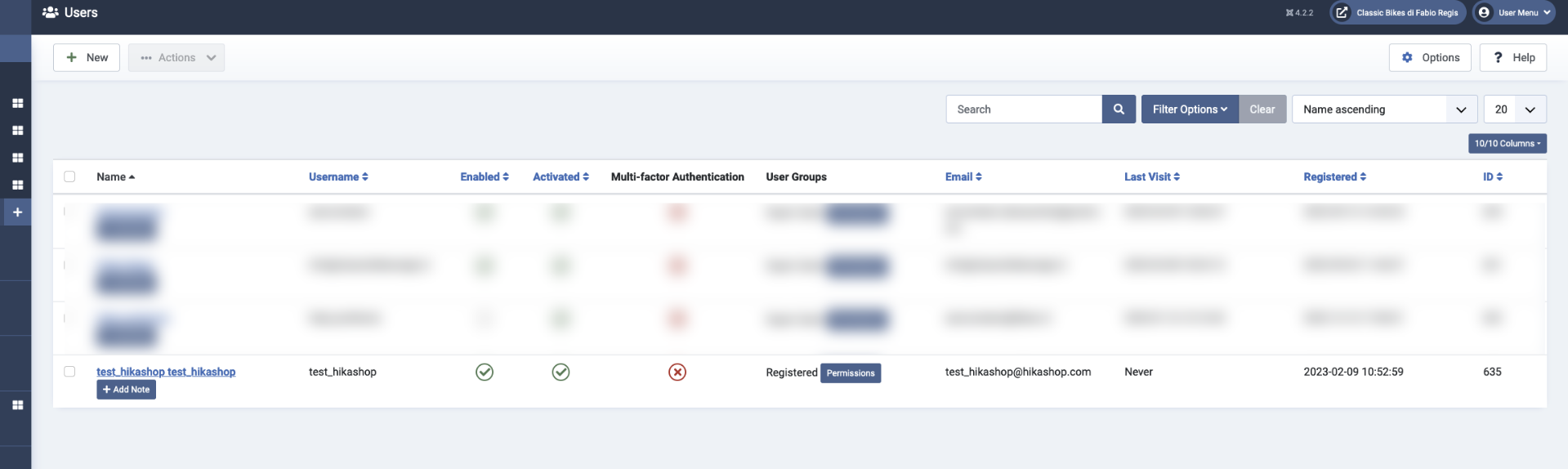

Hi, if I'm not mistaken you created a test user and it's active! (see screenshots)
if you prefer I'll create another one for you, with which email?!

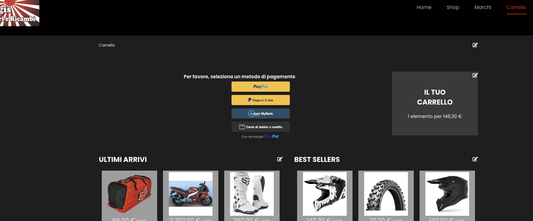

I'm sending you screenshots of the three checkout moments
1) compare the choice of payment methods,

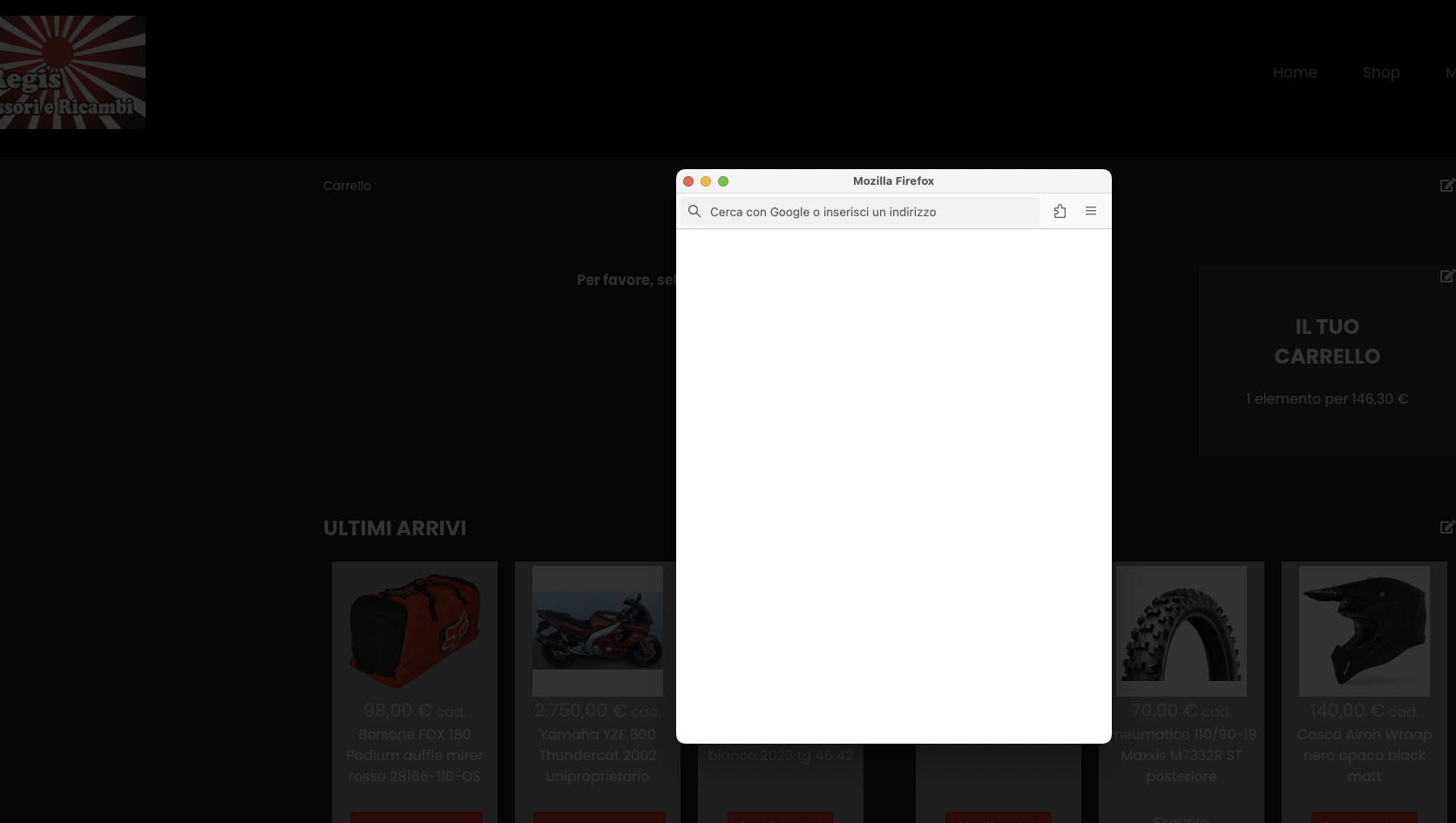

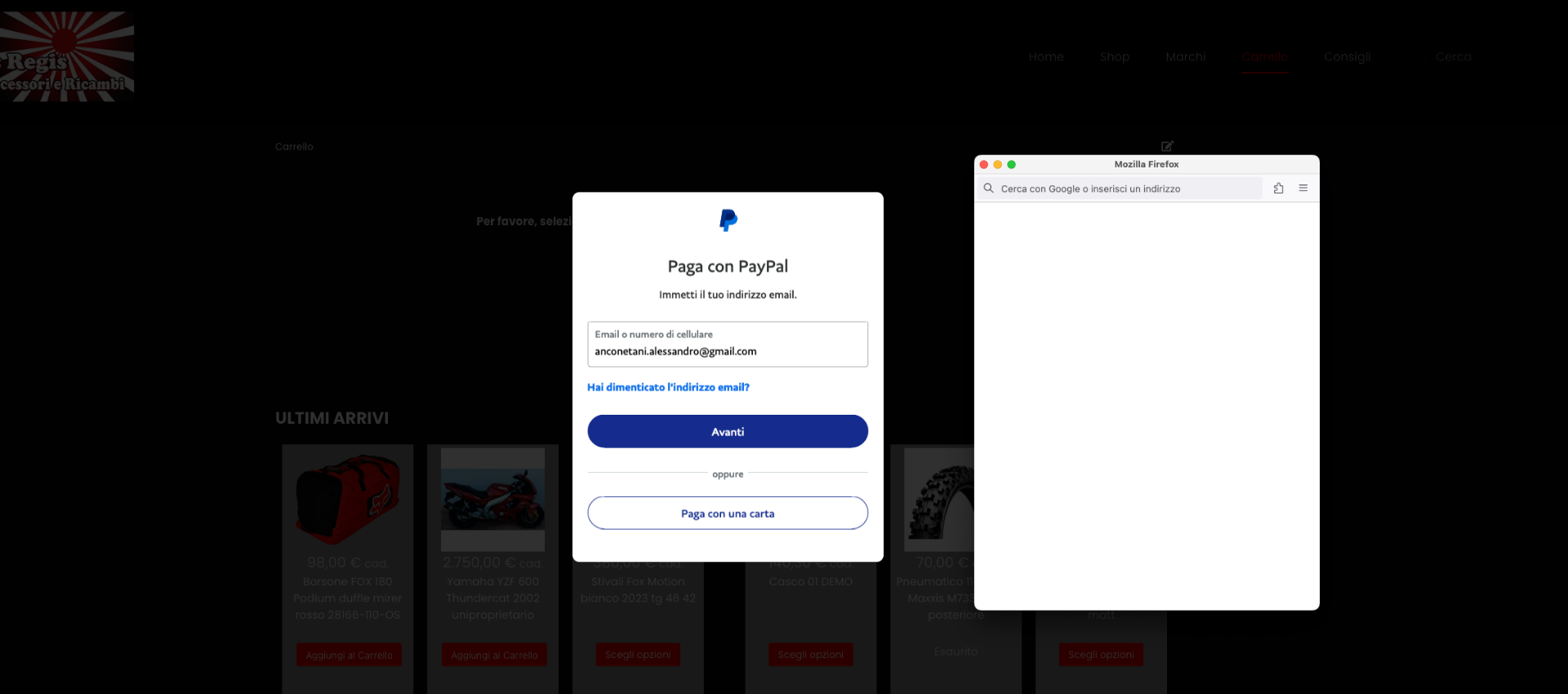

2) any payment chosen by the same defect, opens a popup in front of the PayPal screen
3) I manually moved the white and empty pop up
Thanks for your help!
