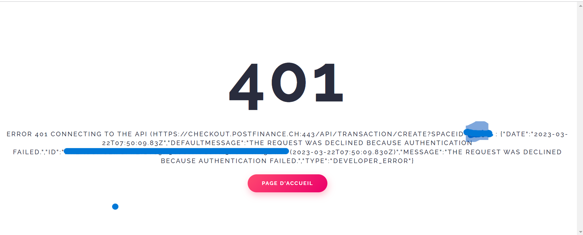

-- url of the page with the problem -- : www.ericspeanuts.com
-- HikaShop version -- : 4.7.2
-- Joomla version -- : 4.2.9
-- PHP version -- : 8
-- Error-message(debug-mod must be tuned on) -- : 401
ERROR 401 CONNECTING TO THE API ( CHECKOUT.POSTFINANCE.CH:443/API/TRANSACTION/CREATE?SPACEID=XXXX ) : {"DATE":"2023-03-22T07:59:05.769Z","DEFAULTMESSAGE":"THE REQUEST WAS DECLINED BECAUSE AUTHENTICATION FAILED.","ID":"XXXXXXXXXXXXXXXXXXXX (2023-03-22T07:59:05.769Z)","MESSAGE":"THE REQUEST WAS DECLINED BECAUSE AUTHENTICATION FAILED.","TYPE":"DEVELOPER_ERROR"}
I installed the plugin Postfinance checkout on your website. I think I inserted all the necessary information as requested. When I process a test order I get this error message. Can you please help me solve this issue? Thank you in advance

Your issue seems to be coming from a configuration issue, that error message says that the credentials set through your payment configuration page via "Hikashop->System->Payment methods->'Your Postfinance configuration page'" are not correct, can you check it and test it again ?
If you still have that issue, you can contact us via email : tsukidev.contact[at]gmail[dot]com

It was indeed a question of rights.
I appreciate your help
