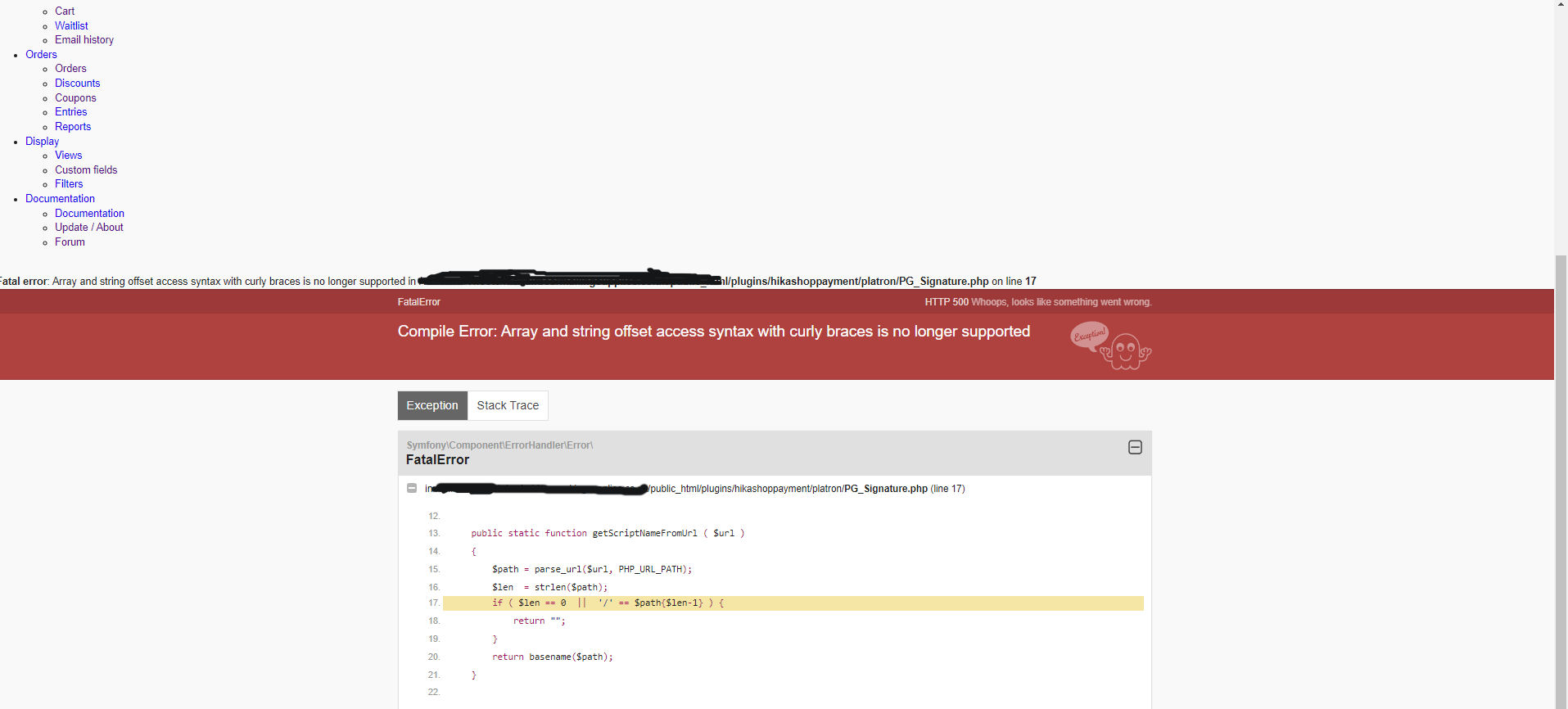

Hi, When I click on the "new" button I get a 500 error, see attached?
  • Posts: 86027
  • Thank you received: 14171
3 years 4 months ago #350661
This error comes from the platron payment plugin.
That plugin is not included anymore in HikaShop and the old version you have on your website is not compatible with PHP8.
Uninstall the plugin if you're not using it. The problem will then be solved.

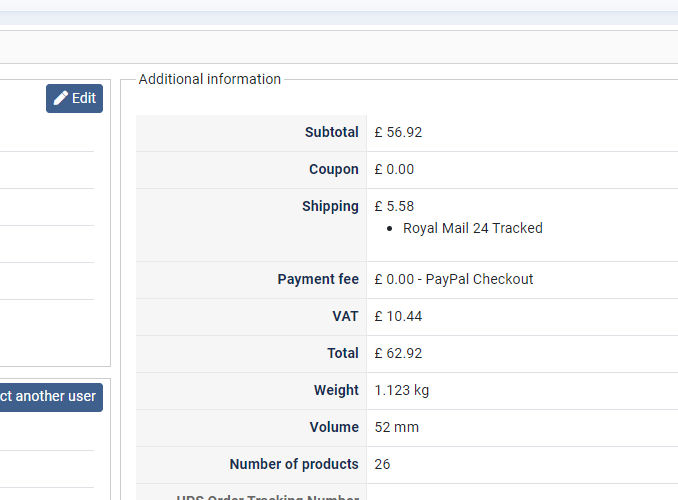

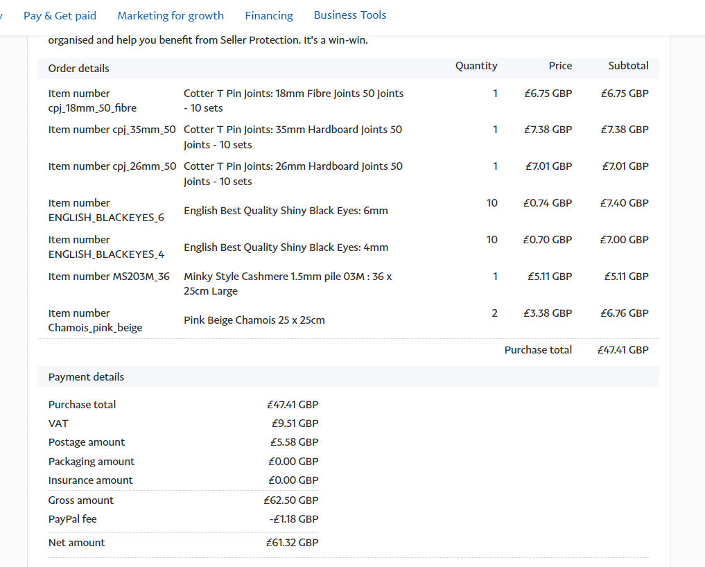

Hi, I think I have found the issue but don't know how to solve it?
see attached Hika and PayPal totals. It appears VAT is NOT being charged on shipping in PayPal even though it is in Hika? Why is PayPal changing the total when it should match Hika?
Last edit: 3 years 3 months ago by mohairbears.

From what I can see of your screenshots, this order was made while the "round prices during calculations" setting was turned off and that's the difference you get.
The sub total of 56.92 in your order corresponds to the subtotal without VAT of 47.41 + the VAT of 9.51
The shipping fee of 5.58 already includes the taxes.
So if you sum up 56.92 + 5.58 you end up with 62.50 which is the total displayed by PayPal. So everything matches.
The only difference is the total calculated by HikaShop which is 51 cents higher and I think it's because of the roundings during the sums being done to get the full total.
Can you please check again ?
Now that the "round prices during calculations" setting is turned on, please place an order with the exact same amount of products and same address and same shipping method on your frontend, and you should normally end up with a total of 62.50 in HikaShop, and thus it will be the exact same total calculated by PayPal.

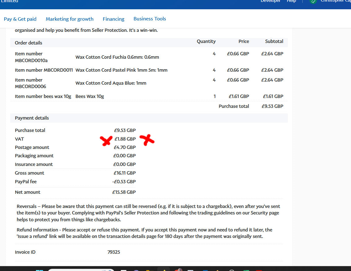

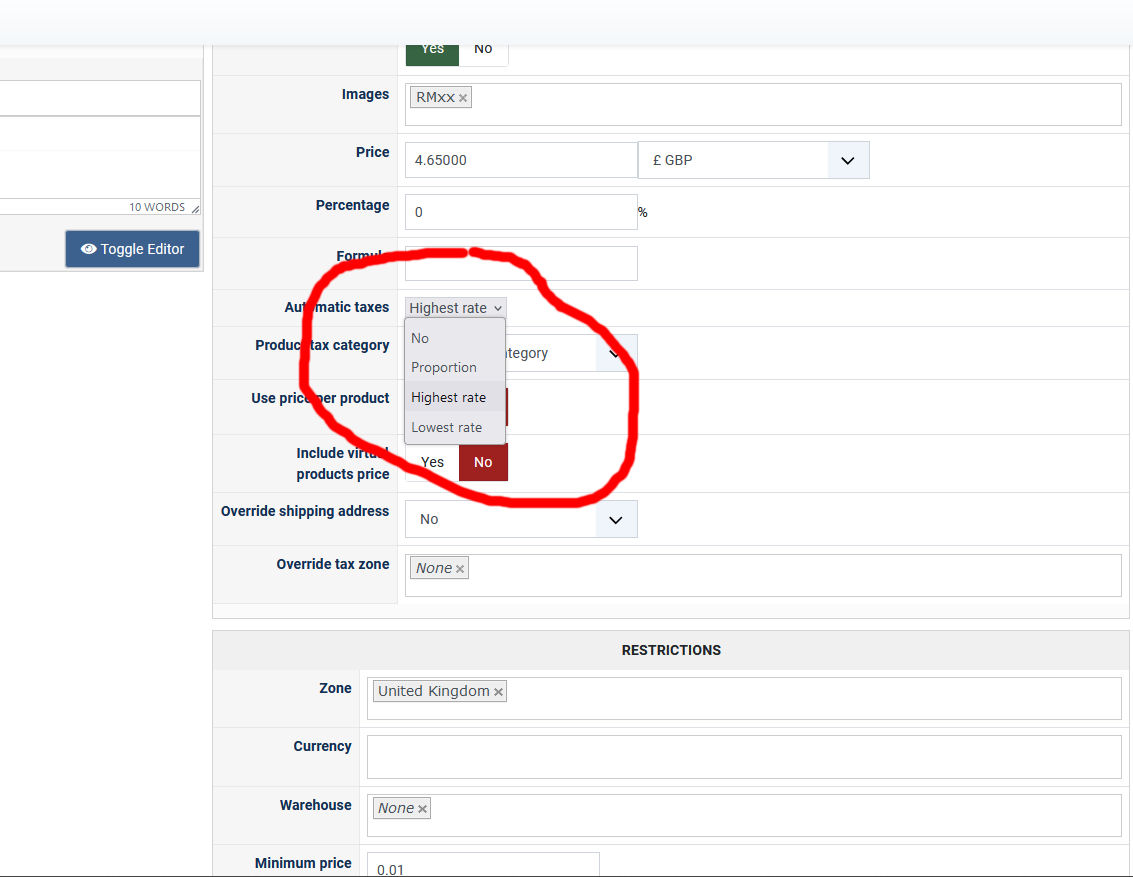

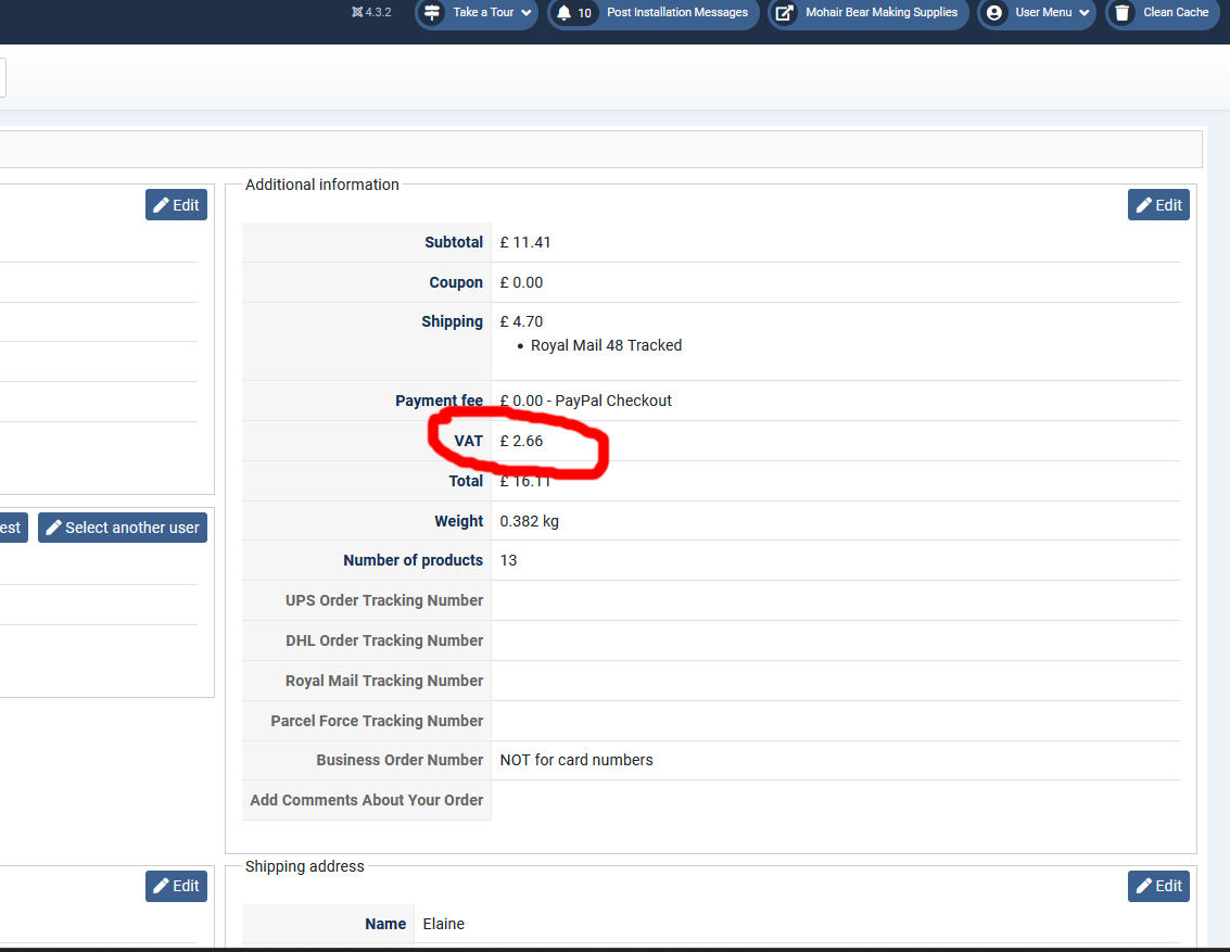

3 years 2 months ago #352140
Hiya, I have found the issue... not sure when you added this function into an update as I don't need to change anything in the shipping methods? but its 'automatic taxes' in a shipping method that was causing the issue? it loos like the default is set to 'NO' which when using the PayPal payment was not sending the VAT through to PayPal?
I have changed the setting to 'highest rate' and this now works. see attched
However, the VAT is not showing in PayPal for the shipping even though the correct amount is now being charged? see attached Hika order and PayPal payment
  • Posts: 86027
3 years 2 months ago #352142
The "automatic taxes" setting's default value is "proportion". If you set it to "no" it will not add any taxes to the shipping fee.
It has been like that for years. If that setting is turned off, then VAT is not calculated for the shipping fee. So in that case, the issue has nothing to do with the payment method used.
Note that everything looks good on your screenshots. I think you're just confused because PayPal displays the details of the order differently than HikaShop.
On PayPal, the VAT amount you see is the VAT only for the "purchase total" which excludes the postage amount. So the postage amount is actually displayed with taxes.
In HikaShop, the total amount is displayed like this: subtotal with VAT + shipping fee with VAT = total
And the taxes amount it provided as information
In PayPal the gross amount is displayed like this: purchase total without VAT + VAT on that purchase total + shipping fee with VAT = gross total
