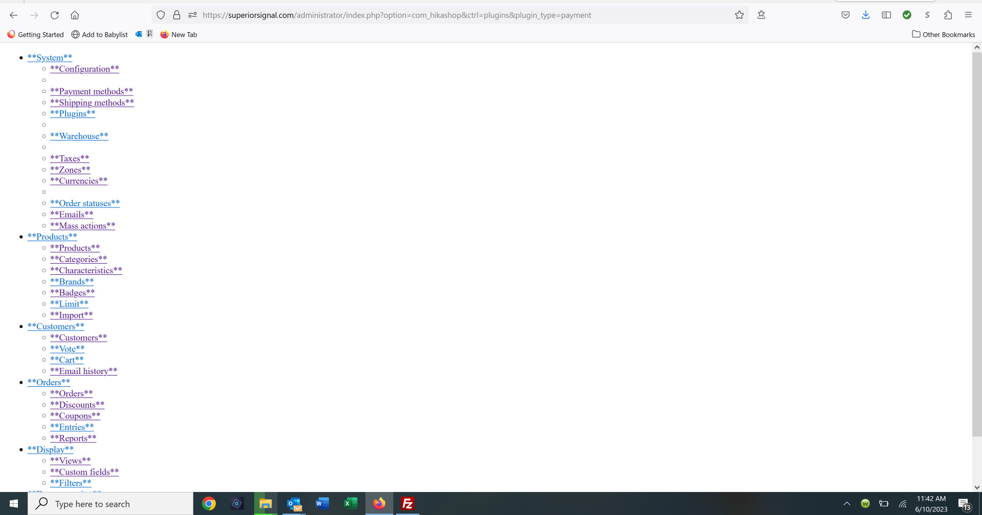

Hello, Since the most recent update I have an error when I select System > Payment Methods > New (button). The page does not load properly. I have re-downloaded and installed the latest version and no change. This is only happening on the payment methods page, shipping methods page works fine.

Please activate the "debug" setting of the Joomla configuration and try again. Please provide a screenshot of what you see on the error page.

Hey Nicolas, I get the same page as with no debug on - only there are asterisks everywhere. I do not see an error code anywhere. (Attached)

The asterisks everywhere means that you've activated the "debug language" setting. You need to activate the "debug" setting instead.
Also, please look at the bottom of the page. The error should be there.

Thanks Nicolas, Double checked and I had both debug language and debug system selected. Unfortunately it shows no error at the bottom. The page ends looking just like attachment in my previous post.
