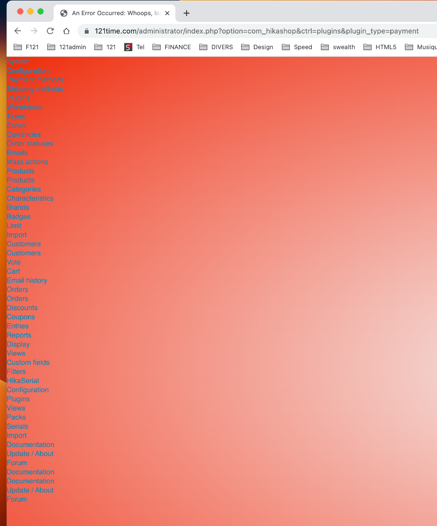

Good morning, after a message to update Paypal plugin, impossible to reach the add new payment method page. Always error
Tired to rename all plugin also but seems not to be successful
Any ideas?
Thank you for your help

This indicates that one of the payment plugins installed on the website is not up to date. It must be one not included in the HikaShop install package.
If you activate the "debug" setting of the Joomla configuration and try again, you'll get an error message at the bottom of that error page which will point at the plugin with the issue. Uninstall it or update it and it should work.
