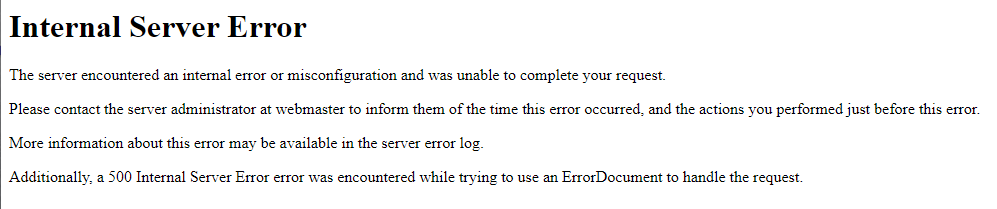

Square has stopped working out of no where. I was working just fine until the afternoon of 9/26. Then it started giving the attached error, and subsequently makes 6 orders each time trying to checkout using the Square payment system.

I reached out to Square support and they contacted back stating that the error is not on their end, but the plugin being used is a depreciated API and needs to be updated.

We just released a new version of the plugin which should fix that issue. Can you download, install and test it again to see if it fixed that issue ? Thank you.
