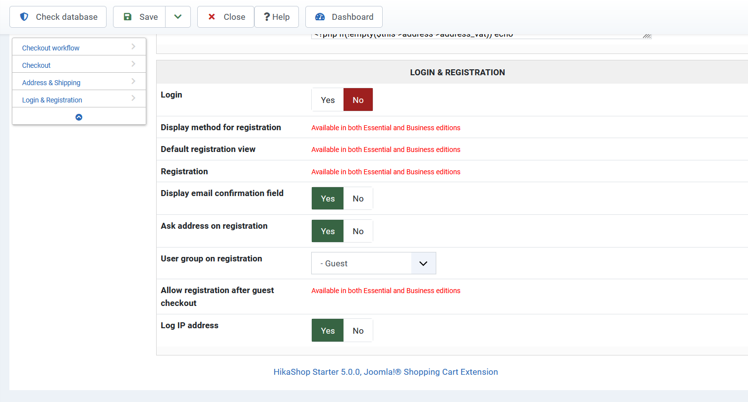

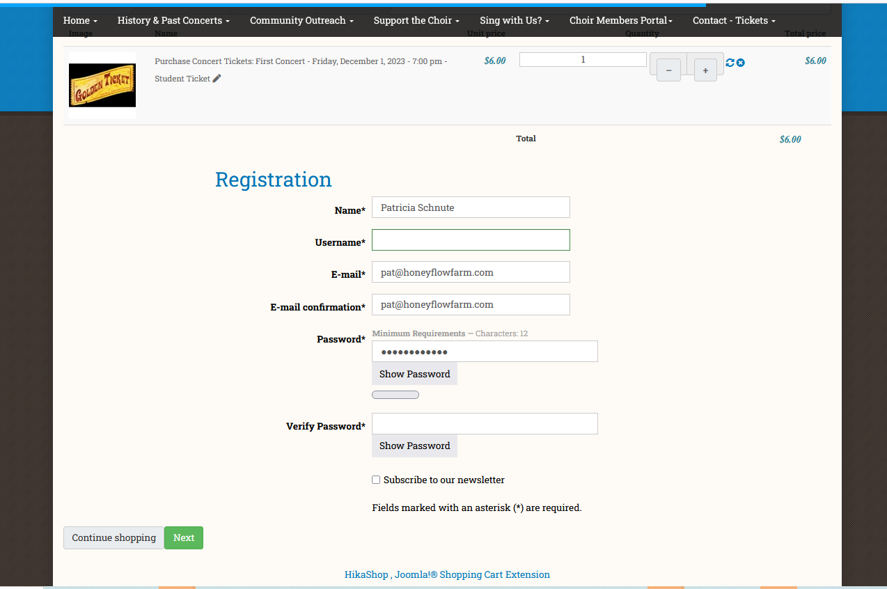

Hello - Renaming the platron folder took care of that issue and I added new stripe and paypal plugins - but now I lost my "guest login" . attached is the setup
Is it set up correct? Here is link to checkout: "brands-listing"
lapeercountyconcertchoir.com/index.php/h...isting/checkout.html
(purchase tickets link for testing = lapeercountyconcertchoir.com/index.php/s...tickets-on-line.html

From your screenshot it seems that you use a starter (free) version, and so as you can see here , it's quite normal that you can no longer use guest checkout with the Starter.
You have to use at least the Essential version to be able to have the guest checkout.
