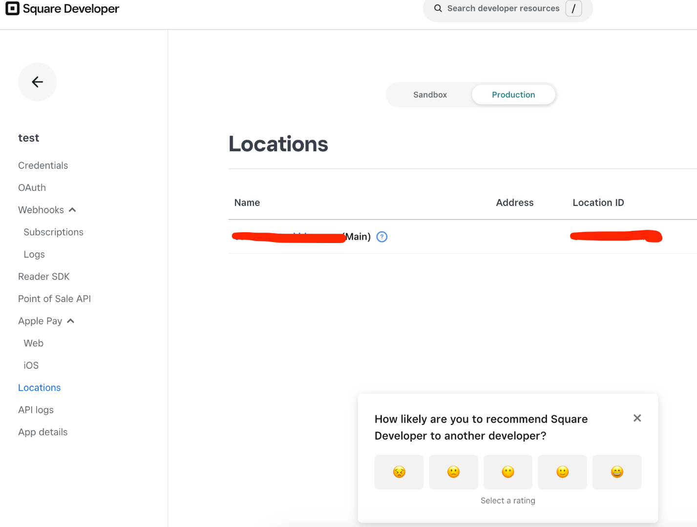

I just checked how you configured your HikaShop Square payment method via « Hikashop->System->Payment methods », and your issue seems to be coming from the fact that you didn’t set a location ID.
You can find it through the location section of your Square merchant account.
Kind regards,
Mohamed Thelji.
