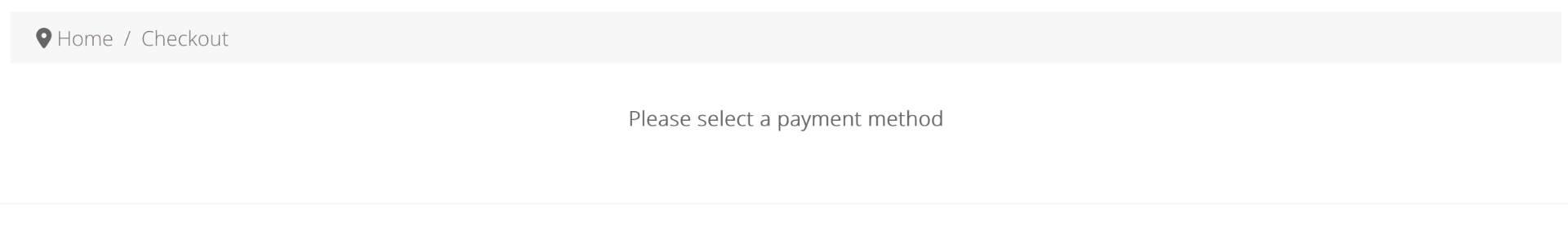

-- Error-message(debug-mod must be tuned on) -- : No payment methods show on the checkout/confirm page when choosing the PayPal Checkout plugin.
The console error is:
Uncaught SyntaxError: unexpected token: identifier
No additional on-screen errors appear, even with error reporting set to max and debug enabled.
We are attempting to replace the old-school PayPal plugin with the new PayPal Checkout plugin using the RestAPI. We've swapped a few sites over to this so far and this is the first time we've experienced any issue with setup. It's also the first Joomla 5 site on which we've attempted to use the PayPal Checkout plugin. Related? Maybe.
The plugin config looks good and we see the "success" message for the Client ID/Secret Key/Merchant ID config.
However, during checkout no payment methods show on the checkout/confirm page when choosing the PayPal Checkout plugin payment option.
The console error is: Uncaught SyntaxError: unexpected token: identifier
No additional on-screen errors appear, even with error reporting set to max and debug enabled in Joomla and in the payment plugin.

I believe the file and line number are shown in the screenshot I attached of the console error.
