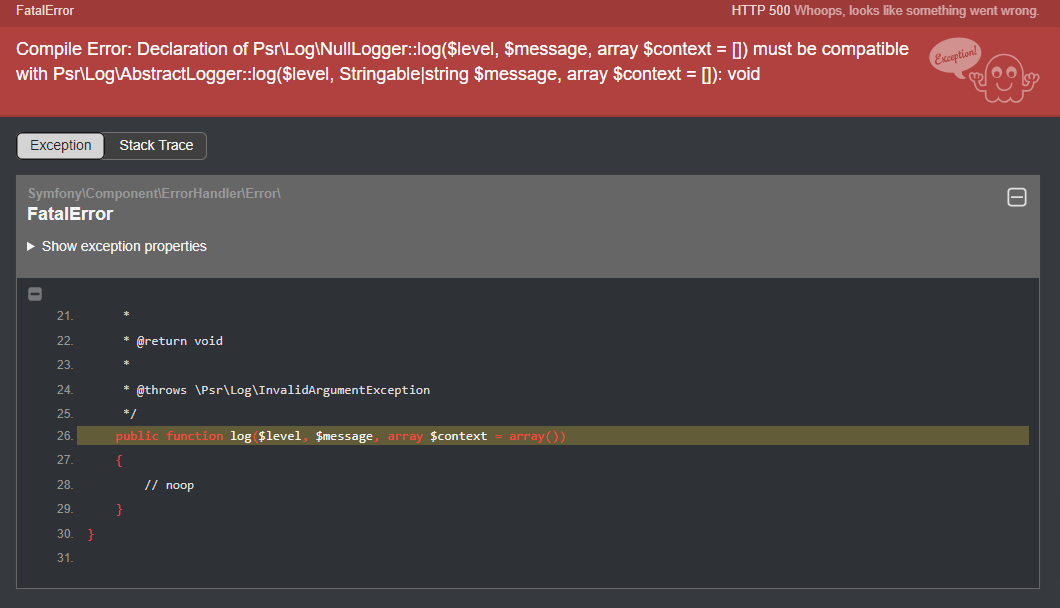

When I activate the alma pay plugin the following 500 error occurs.
I downloaded the plugin again from the link in the purchase order and the result was the same.
I think the error comes from the version of Alma that does not adapt to J! 5.

Thank you for your feedback. We've released a new version of the payment plugin in order to fix this. Download it again on our website and install it on yours and it will fix the problem.

In the purchasing process, when we select the payment option "AlmaPay" and then click the "pay" button, instead of redirecting us to AlmaPay, a pop-up window appears with the text - the "purchase_amount" field needs to be an integer "double" found -

Thank you for your feedback. I've made a patch in order to fix this error.
Download again the install package of the plugin on our website via the download link provided on the order details page and install it on yours to get the patch.
