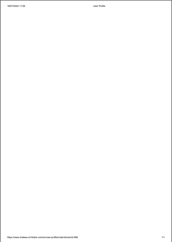

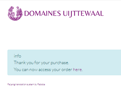

I have updated the pugin and I have a confirmation on the font that the command is confirm and payed see above

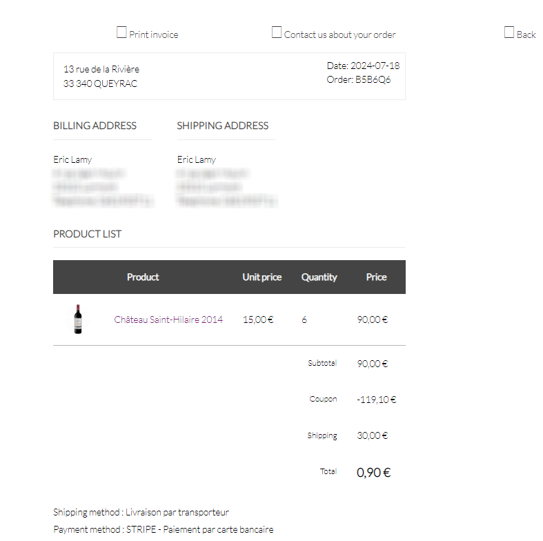

and the order seems to be fine
But when I click on print my invoice, the document is empty..
The order is confirm
Do you have this kind of feedback since the update ?

This looks like a PHP error happening while the invoice is being generated.
It's probably caused by a customization of the invoice view.
Turn on the "debug" setting of the Joomla configuration, and turn on the "error reporting" there too.
Then, reproduce the error and you should get an error message on that white page which should help us tell you where the problem is.

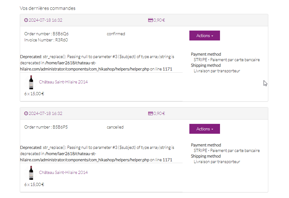

Indeed it seems to be a PHP problem. Here is the screenshot on user dashbord
Actually PHP Version is 8.1.29
Adishatz, erix
www.agerix.fr
  • Posts: 86027
  • Thank you received: 14171
2 years 2 weeks ago #362270
While it is interesting to get this report on the deprecated message, the problem with the invoice doesn't come from this. You need to look at the invoice with the debug activated. Do you see any error message there ?
I've added a patch for this deprecated message. If you download the HikaShop install package on our website and install it on yours you'll get the patch. That will remove the deprecated message of your screenshot. But it won't change anything for the invoice.

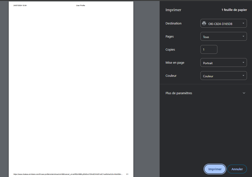

Thank you for the patch for deprecated, I don't have anymore the message with debug max.
If I don't publish any screenshot about the printing feature, it is because even with the debug max or error reporting, I still have an empty page for printing
I have the details on order page but I can't print it
Adishatz, erix
www.agerix.fr
  • Posts: 86027
2 years 2 weeks ago #362279
I can only think there is some kind of error in a customization of the invoice, or another plugin which needs to be updated (like if you're using an old version of the PDF invoice plugin, or an old version of HikaSerial, or a custom plugin, or something like this).
Could you provide a user access with the URL of an order with the issue so that we could check the situation ? Maybe we could figure out something from directly looking at it.

If I open the popup URL in a new tab, I can look at its HTML with my browser's inspector. There, I can see all the HTML code of the invoice. So that means that the issue is a CSS issue. So I then looked at the elements encompassing the invoice HTML code and checked their CSS for anything which could hide the area. By going up and up, I finally reached the body tag of the page:
i.imgur.com/K4OM9Kr.png
I can see there is a "modal" class added by the template in the "body" tag of the page. And that class has a "display:none;" in the bootstrap CSS file loaded on the page.
I think that the problem comes from the template adding this "modal" class to the modals content. This was not a problem in older versions of bootstrap, but after updating to a more recent version of boostrap, the modal class' CSS in boostrap must have changed to include that display:none; leading to your issue.
The solution is probably to edit the component.php file of the template and remove the "modal" class from the body tag.
