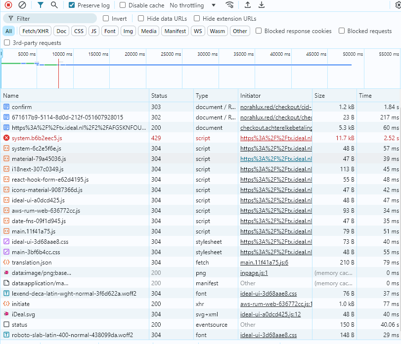

As Pay does not support the plugin, i did this thing i saw once with checking network. Here is a screenshot
Last edit: 1 year 9 months ago by NicoW. Reason: adding screenshot

On your screenshot of the network, I can see that the confirm page, which then redirects to the payment gateway is sent in 1.84 seconds. In these 1.84 seconds, HikaShop transforms the cart into an order, saves the data of the order in the database, triggers the plugins for the order creation, sends the emails (if any), the payment plugin generates the redirection data, and Joomla and the template display the rest of the page. So there is a lot going on and 1.84 seconds seems normal to me for all this.
Then, there is a request for a javascript file of Ideal which takes 2.52 seconds just for that one javascript file. I don't think there is anything you or us can do for this. This is purely something to do with the payment gateway and you should report this to the payment gateway if you want to do something about it.
