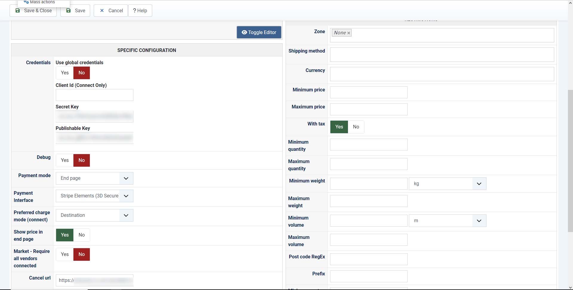

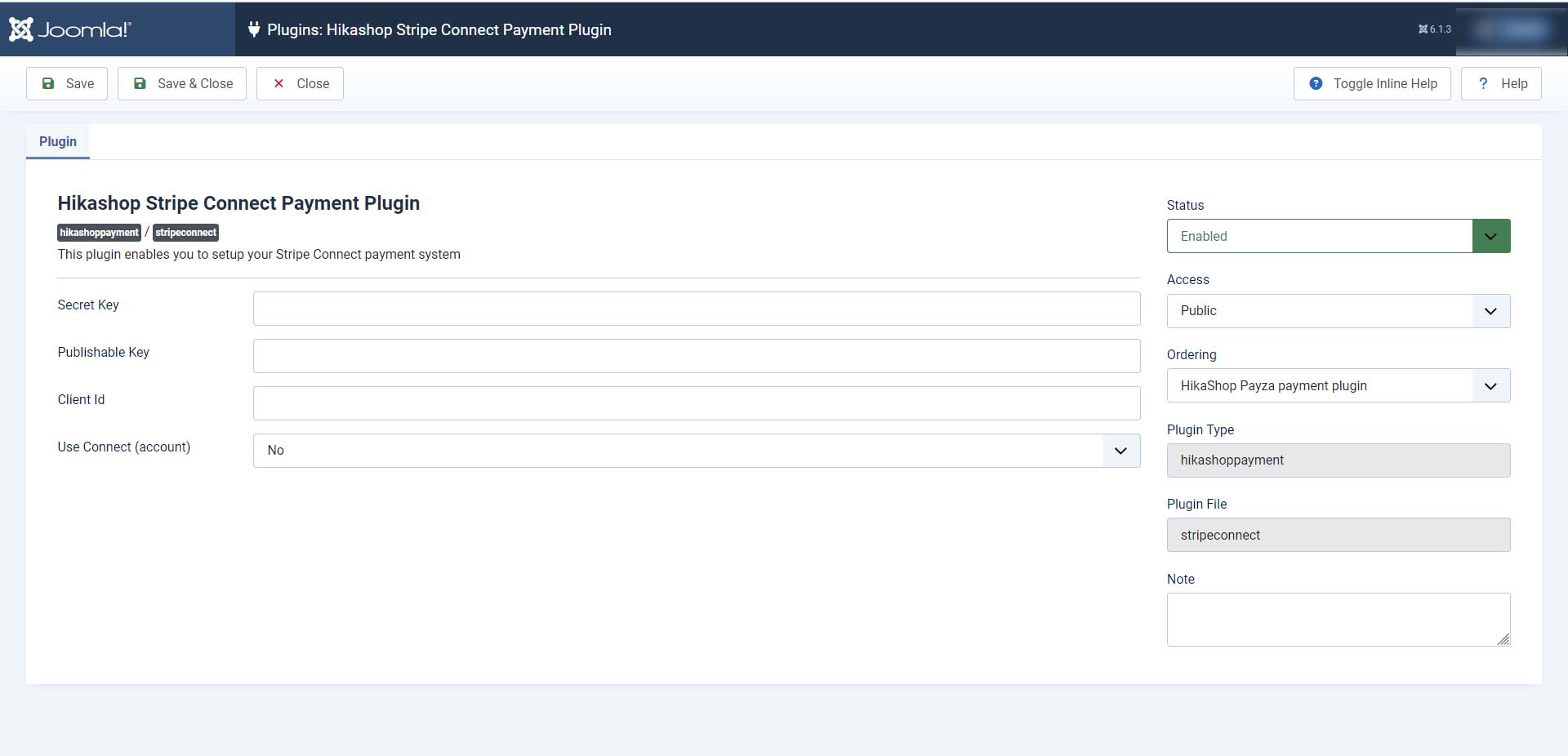

I'm using:
Joomla 6.1.3
Hikashop: 6.5.2
Stripe Connect, end page - I couldn't find the version number anywhere but it seems to be from July 2024 which is the last time I downloaded the zip file.
I did find something a little strange when looking for the Stripe Connect version number. Of course I have it set up in the Hikashop Payment Methods, with both keys etc. But there is also a plugin in Joomla > System > Plugins which is enabled but does not have any settings. Images are attached. Do I need both of these?
