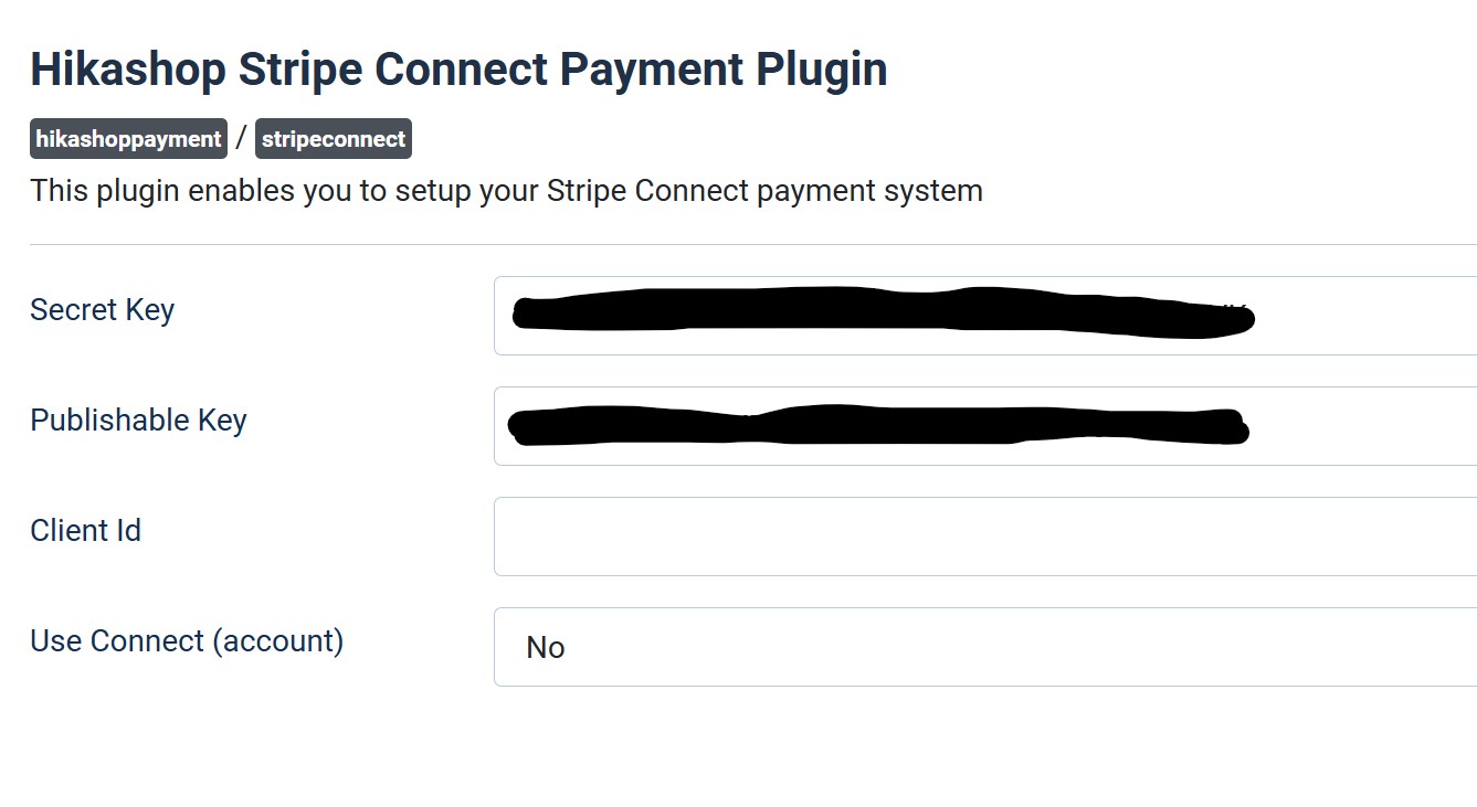

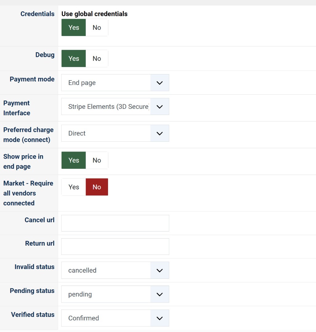

3 months 3 weeks ago #371797
Stripe Connect configuration

Thank you for the screenshots and sorry for the delay.

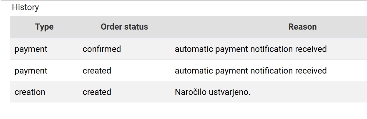

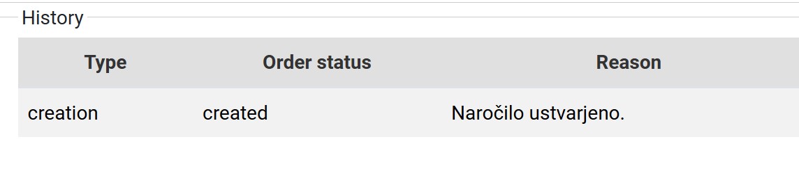

Yes, as mentioned, the customer gets to the end but doesn't even offer him the option to enter his card details. It simply shows him the thank you page and that the order is being processed. The problem occurs in some random key that we can't decipher.
Yes, it's Stripe connect 1.2.5 (obsydev).
I'm attaching a screenshot of the history in case of a successful purchase and in case of a fail.
3 months 2 weeks ago #371874

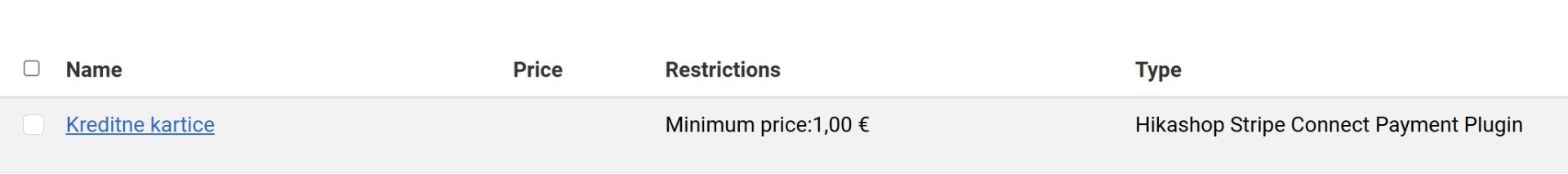

Thank you for the screenshots but unfortunately, just a part of the order history does not allow me to understand the situation.
Like I wrote, I also need the payment method attached to the order.
By design, it should not be possible for the plugin to just let the order be created ; so I need to understand the source of the issue, which could be related to restrictions, plugins, etc.

For these orders, the payment method Stripe credit card is selected as mentioned at the beginning.
I don't know how else I could look or confirm. The payment method of the order is visible in the order list, in emails, invoices ...
If you need any other information, please define exactly where I should look.
