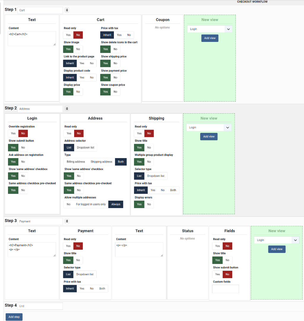

  • Posts: 21
2 weeks 6 days ago #373238
Hi Nicolas
Thank you for testing out the Entries. Glad you were able to confirm that's not an issue.
Here is some additional feedback feedback for you:
On the card order: Yes, "payment confirmed automatic payment notification received" is added in our current Hikashop 5.1.6 and the new 6.6.0, when it was active, order history at the time the order completed.
Yes to "payment notification : payment" email is not a customer email. I was just saying it was in the Email log.
We did not change any settings at all in HikaShop when we updated from 5.1.6 to 6.5.2. That's when we noticed there were fewer emails in the email log when an order completed.
When we updated to 6.6.0 the checkout process would not go beyond step1, so we could not complete an order of any kind.
I am attaching a screenshot of our checkout configuration in case it is helpful.
Let me know if you would like any additional information or configuration settings from our working 5.1.6.
Thank you
Edwin
