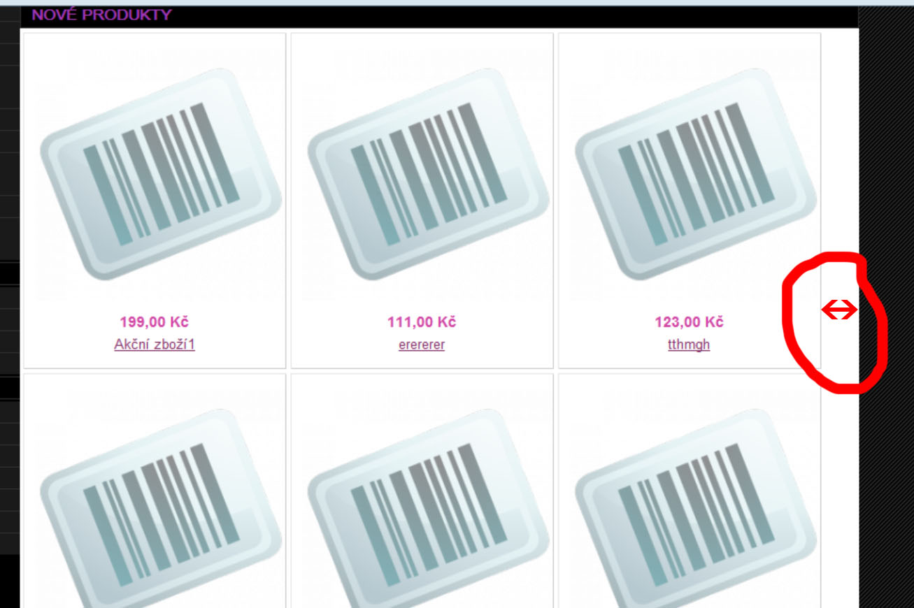

the list of products of my HS is not completely on whole width of the site. How can I make it wide the same as the template? The cart, product details etc are all the full width. Please check the attached file for reference.

You'll be able to do it with some CSS customization, you can give me a link to that page if you want more precision about the CSS code to apply.

Using this CSS code will probably do the job :
.hikashop_products .hikashop_product {
width: 25% !important;
