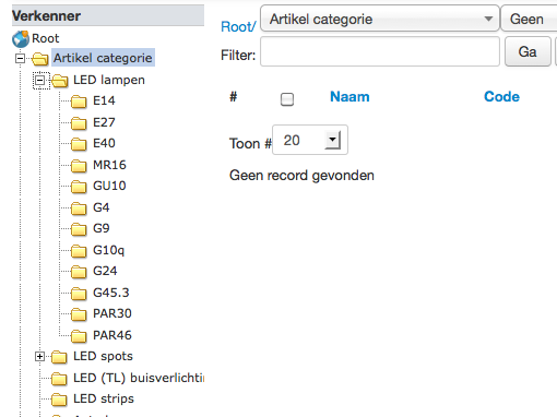

See image:
In the category, first I would like to show DIV (picture and titel) for example Led lampen, when you choose Led lampen, I would like to show E14, E27, E40 .... as a list and next to it the products when you choose E14, all the E14 products.
Is that possible? And how to do it?
Greetings Jarno

  • Posts: 64
12 years 10 months ago #118890
Thanks,
I would like that the category to be DIV and the subcategory a list and product display. How to do that?
Greetings Jarno

  • Posts: 64
12 years 10 months ago #118977
Sorry, it's my Englisch... hard to explain
When you go to: erdoverlichting.nl/webshop
First you will see the categories.
When you click on for example "LED lampen" you will see the E14 , E27 and so on.... thats the fitting of the lights.
I would like to keep the category show the way they do now, but when you click on for example "LED lampen" I would like to show a list of fitting on the left side and the rest of the page, all the products in DIV that are in the category "LED lampen" When you click on E27, only the E27 fitting lights will show, but the list of other fitting stay until you go back to an other category, than there is an other list of of subs.
I hope that I explain it good :)
Thanks, greetings Jarno
