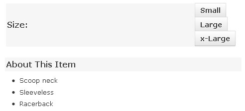

12 years 11 months ago #126442
Oh I may be able to get it to work then without going into the files.

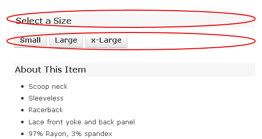

What I was trying to do is get the label across the page and the options below it as per the example attached that reads "about this item". But as you can see it's squished. This is the CSS. I thought adding 100% would make the other td wrap to the next line.
.hikashop_product_characteristics_table td:first-child {
	width:100%; margin-top:20px; margin-bottom:5px; font-weight:bold; background:#F6F6F6; padding:4px 0 4px 2px; }

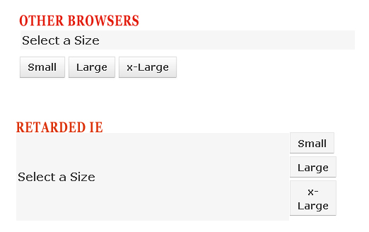

I got it to work except in IE - this browser is such a pain :( Thanks anyway...
.hikashop_product_characteristics_table td:first-child, .hikashop_product_characteristics_table td.ie7_class44 {
	display:inline-block; width:100%; margin-top:12px; margin-bottom:5px; font-weight:bold; background:#F6F6F6; padding:4px 0 4px 2px; }
  • Posts: 26384
  • Thank you received: 4077
12 years 11 months ago #126576
I don't think that IE7 supports the ":first-child" css rule.
  • Posts: 966
  • Thank you received: 11
12 years 11 months ago #126578
It doesn't seem like IE8 supports it either 'cause I have IE8 (for testing) and it ignores it.

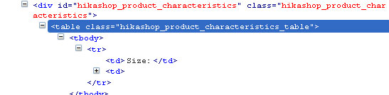

I was looking at the file: administrator/components/com_hikashop/types/characteristic.php
I was thinking that if I moved both content (the characteristics header and characteristics) in one TD that it may help me style it better to conform to IE.
I made some changes but no luck - so is it not possible or could it be that I am just missing something? I HAD made the change in the section below but put it back to the original.
<table class="hikashop_product_characteristics_table">';
	$config =& hikashop_config();
	foreach($this->characteristics as $characteristic){
		$main_html.='<tr>';
		$values = array();
		if(!empty($characteristic->values)){
			foreach($characteristic->values as $k => $value){
				if(!$config->get('show_out_of_stock',1)){
					$hasQuantity = false;
					foreach($element->variants as $variant){
						foreach($variant->characteristics as $variantCharacteristic){
							if($variantCharacteristic->characteristic_id==$value->characteristic_id){
								if($variant->product_quantity != 0 || $element->product_id==$variant->product_id){
									$hasQuantity = true;
					if(!$hasQuantity) continue;
				$values[$k]=$value->characteristic_value;
		$html=$this->display($characteristic->characteristic_id,@$characteristic->default->characteristic_id,$values,$params->get('characteristic_display'));
		if($params->get('characteristic_display_text')){
			$html=$characteristic->characteristic_value.'</td><td>'.$html;
		$main_html.='<td>'.$html.'</td></tr>';
	$main_html.='</table>
Thanks!!

I guess you misunderstood my question. As per the attached pic, the top and bottom content - that is circled - are in their own TD. I was wondering how to move them into ONE TD and, if that would cause an issue.
  • Posts: 86107
  • Thank you received: 14207
12 years 11 months ago #127449
You would have to change the code:
to:
$html=$characteristic->characteristic_value.$html;
and they would display in the same td.

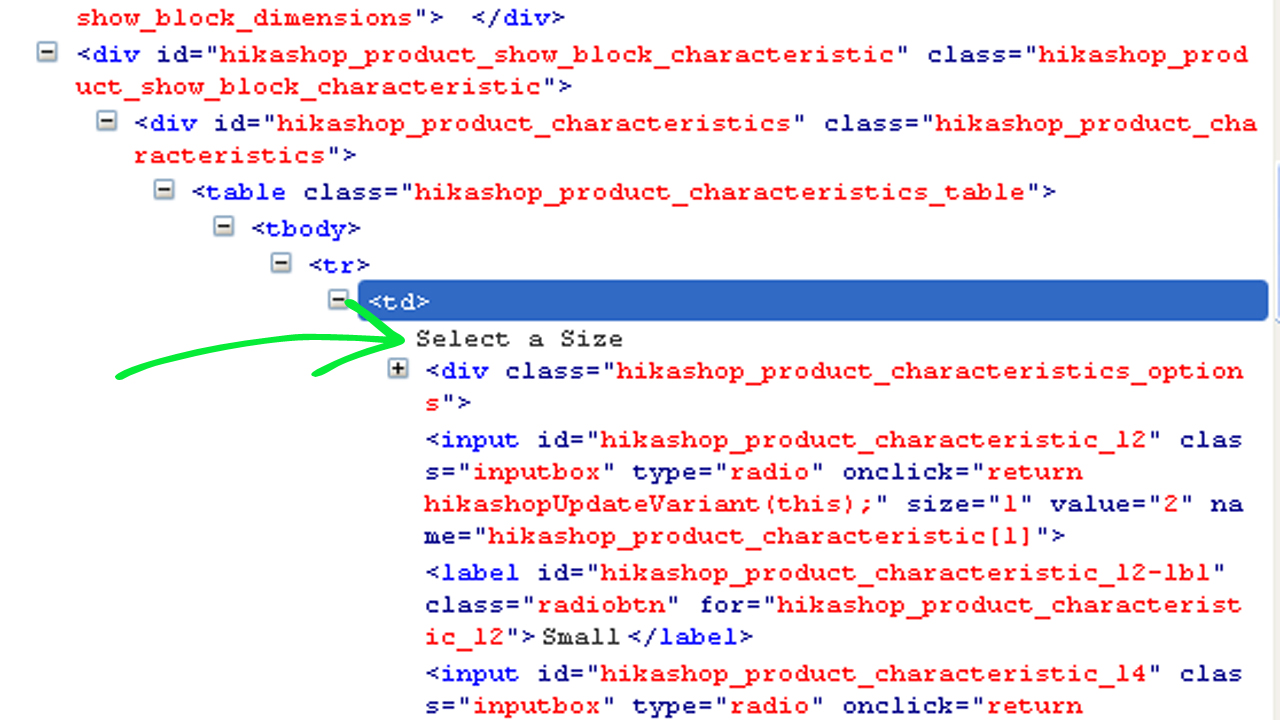

  • Posts: 966
12 years 10 months ago #127578
Thanks nicolas that is what I was referring to.
Really sorry to bother you, but can you tell me which part of the code has the "Select a Size" text? I would like to put a div around that.
Please see the attached pic.
