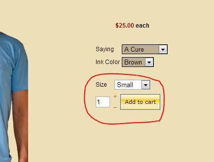

Hi Guys- Please help, I can not find this anywhere! Can you please point me to the line of CSS to edit to adjust the background color of the custom field box and item quantity? I would like to match it to the Joomla template. Please see attached.
Thanks so much for all your support!!! I am getting so close to finishing my shop thanks to your help.

12 years 10 months ago #127680
That CSS should do it:
select#size, .hikashop_product_quantity_field{ background: #BCAF90; }
You can add it as explained here:
