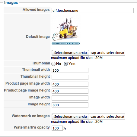

I am using the shadowbox extension and when clicking for an enlarged pop up image I don't get it limited to 800px in height as I have setup in my configuration - Main - Images section.
Shall i change something else to make it effective?

The size set through HikaShop - Configuration - Main -> Image height
is applying when uploading images from the HikaShop component.
But this resizing doesn't get applied when uploading from HikaMarket frontend.
Is this a bug or shall I configure something ? I don't see many settings to be applied in the Hikamarket configuration screen.
