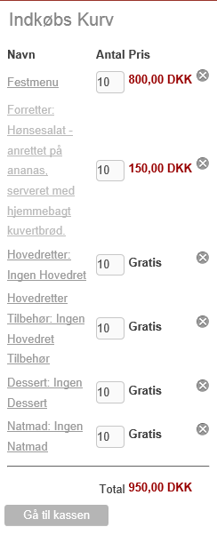

Capture 1 shows my first problem , this is a order made from 1 product with some options , i would like to only have quantity and Price on the main product.

12 years 10 months ago #128124
For the first one, I think that you just have to enable the option "Group options with product"

  • Posts: 8
12 years 10 months ago #128167
Thanks alot problem 1 solved :)
