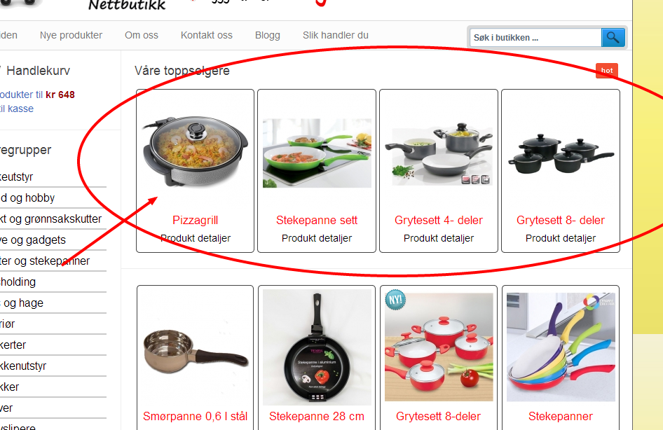

Hikashop version 2.0
Joomla 2.5
I have the "Hikashop content module" enabeld in the product listning, so that it is displaying the bestselling product at the top of each category. see image below

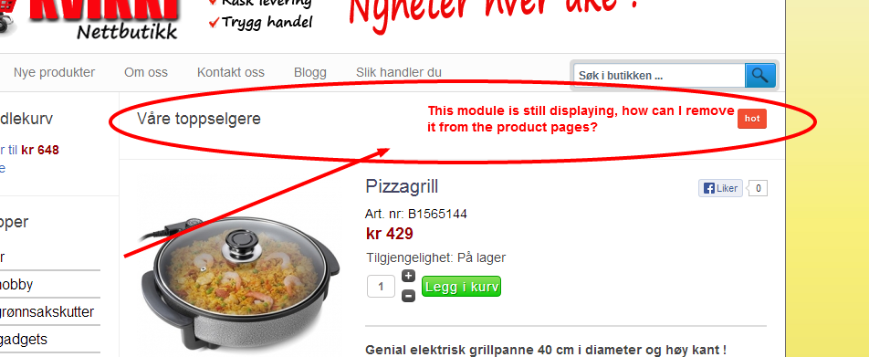

But When I click on a selected product, the module is still displaying. It is not showing any products, but the title of the module is still displaying. How can I make to "Hikashop content module" NOT to display in the product pages ? (See image below)

I guess you have configure modules to be shown under the product page (in the HikaShop configuration).
  • Posts: 344
12 years 10 months ago #129468
Yes I already have to modules there below the product on the product page, but I only want this module to display at the top of the category listings, and NOT above the product in the product pages, is there any way to remove it ?
12 years 10 months ago #129506
You probably used the "Modules under the product page" option of the Display tab of the "Hikashop->System->Configuration". If not, you should :
- Go to your Module configuration page through your Joomla module manager page
- Set the "Module Assignment" option to Only on the pages selected
- Only check the menu where you want your module to be displayed.
  • Posts: 344
12 years 10 months ago #129580
That did not work, but I found a solution
I just used the plugin loadmoule position and placed the "hikashop content module" in a new module position that I just called "tester", and then I added this code to the file: listing_div under category....
<?php
$mypostion="{loadposition tester}";
echo JHTML::_('content.prepare',$mypostion );
Now the module is just showing at the top of the category, and not on the product page.
Regards =)
