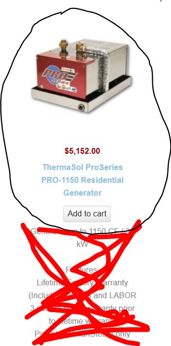

the first link shows a category view with read more
for the second link, i want just a normal category view without ANY description, just the normal image and title with add to cart button

12 years 10 months ago #131067
I'm sorry, but you still don't seem to understand, so let me try again....
This page is fine..."read more" is below "add to cart button".....
www.plumbingdeals.dreamhosters.com/index...-mr-steam-generators
This how how this page should look...
www.plumbingdeals.dreamhosters.com/index...auna-steam/thermasol
This page should show ONLY image, title, price and cart button...NO description or read more...
www.plumbingdeals.dreamhosters.com/index...thermasol-generators
